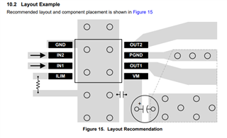

Is PGND in Fig. 7.2 the "power" ground? i.e. the DC motor ground? which is different from GND in Fig. 7.2, which is to be connected to the microcontroller ground?
