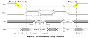

Looking at the datasheet, I'm curious if there's a SPI transfer timeout for the communication. Another description would be is there a time where, if the SPI communication takes longer than x micro/nanoseconds the communication times out.
Does that exist?
Working off the specs given in the datasheet, the SPI timing requirements has the minimum SPI clock period at 100ns (Table 6.6). During SPI communication, the DRV8305 is looking for 16 bits of data (Section 7.5.1.1). If the data to SDI =/= 16 bits, then it’s considered a frame error and the communication is ignored.
Multiplying it out, I’d think that anything longer than 1600ns would not be valid. I guess another way to put it would be that SPI commands would all have to execute within 1600ns to be valid.
Is that accurate?

    • Understood that in SPI protocol described in the datasheet, a frame error will ignore the command if anything other than 16 bits is received
      • However, as you mentioned, I don't see a spec for the maximum time period for the SPI clock period or SDI input period
    • Instead, I think the criteria for SPI frame #bits will actually just be the window of the nSCS (chip select) pin being Low.
      • e.g. when nSCS is toggled High again, the # of bits received while nSCS=L will be checked. If !=16, then an error occurs and SPI frame ignored.
      • this mechanism may not be time-sensitive, since I feel like my team members have tried bench scripting w/ operating SPI even as slow as 30microSeconds for one SPI frame without issue

    Now that I think about how the timing is spec'd, the minimum SPI clock period would actually mean that 100ns is the shortest duration so that'd actually be 1600ns as the shortest possible SPI message.

    You would be correct that the interpretation is inversely related (that max SPI freq corresponds to min clock period)!
    • one other clarification I'd like to add is that the 1600ns is just for the actual clock pulses themselves,
    • and the 1600ns estimate doesn't yet include all the setup/hold time delays described in the 'SPI Timing Requirements' datasheet section

    From discussion w/ the team, I believe that my earlier response should be correct for this device -
    Should be able to slow down SPI communication as long as you're following the SPI datasheet requirements for timing, frame format, and addr/data values.
