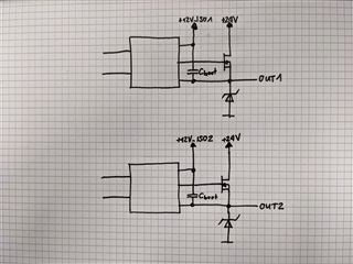

Hello
I am need for two outputs of a gate driver two isolated 12V power supply to load the Cboot. How is it the easiest way to generate this two 12V power supplies?
I found the SN6501 and SN6505 but I haven't found a transformer with two 12V outputs.

  • Hi Koteshwar
    Thanks for your answer. I look again for a suitable transformer. I don’t want to use a customized transformer.
    Is there another easy solution to build two isolated 12V supplies?

  • Hello Manuel
    I would like to have one input with 12V or 5V and two isolated 12V outputs.

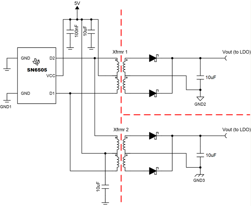

  • Hi Céline,
    If the two 12V outputs should be isolated from each other, the configuration below can be used:
    The transformer outputs do not need to be isolated from each other and can share GND potentials on the output side in this topology too. This configuration is optimal for 5V inputs since the input power supply can be connected to SN6505's Vcc directly. SN6505B can be used, and the transformers will need turns ratios ~3.1 to step the voltage up to 12V, like Pulse's PH9185.013NL or Coilcraft's JA4650-BL. Turns ratios would need to be slightly higher if an LDO is used to regulate the outputs.
    The downside of using this topology with 5V connected is that less current will be available on the output sides combined -- limited by a factor of 1/N, the turns ratio of the transformer used. If support for load currents >300mA is needed or if a 12V input power supply is preferred, please let me know and I can share additional options.

  • Hello Manuel
    Is this solution with two transformer? I have to do a redesign and there is not alot of space. It would be better if I have to place only one tranformer for the two outputs. I dont have a preference for the power supply, I have a 12V and a 5V power supply on the PCB. The most importent part is, that the circuit is small, available and not too expensive.

  • Hi Céline,
    The solution I shared above shows two transformers in separate packages, but two transformers integrated into a single package can be configured in the same way. I am not aware of a commercially-available part that would support two 12V outputs like this, but you can check with your preferred magnetics vendor since many are willing to make custom devices meeting your electrical and layout requirements.

  • Hi Manuel
    This is my problem that I cannot find the right transformer. So is there another solution than with the SN6505?
