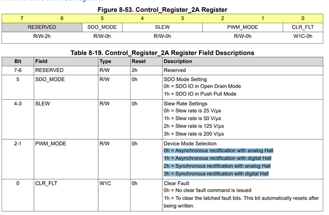

I am testing this eval with Asynchronous rectification with analog Hall (PWM Mode 1) and it is somehow working as expected (motor spinning)  with my digital hall motor. (HNx all floating with pullups on HPx). However, when I switch to Asynchronous rectification with digital hall (PWM Mode 2), it works intermittently. As in, I apply a PWM and it works, and then I apply 0 PWM and apply a PWM  again, and sometimes it works, sometimes it doesn't. Once it doesn't work, it won't work ever again until PWM mode is switched to mode 1 and back to mode 2...
Can I get a confirmation that Control Register 2A is properly documented?:
    This is documented correctly.

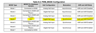

  • Hi Jerome,
    I would try to follow the settings of Mode 4 below in SPI.
    Can you clarify what modes you mean by Mode 1 and Mode 2? As in PWM_MODE = 1h and PWM_MODE = 2h? I'd expect it to work in PWM_MODE = 2h using synchronous modulation and ASR and AAR being enabled or disabled.
    I'll try with my MCT8316ZTEVM with the SPI variant on it today if I get time to see if I can replicate the issue.
    Aaron
  • Hi Aaron,
    Sorry about the confusion. Mode 1 should be PWM_MODE = 0h and Mode 2 should be PWM_MODE = 1h. I was using Table 8-2 terminology:

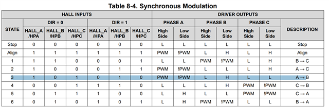

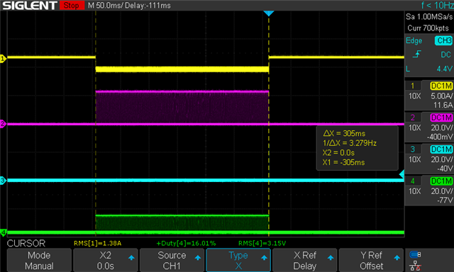

    I have a scope shot of what is happening that is causing the Motor lock fault when the motor fails to spin in digital hall mode:
    CH1: A Phase Current, CH2: A Phase Voltage, CH3 B Phase Voltage, CH4: C Phase Voltage
    This looks like state 3 as Phase A has the 24V PWM signal, Phase B is asserted LOW, and PHASE C is floating:
    However, upon probing the halls, both single endedly and differentially the state of the halls during this period is:
    HPA: 3.3V
    HPB: 3.3V
    HPC: 0V
    With a DIR = 1, this should be state 4 instead of state 3...
    Again, very weird how analog hall mode is working consistently whereas it is only in digital hall mode where this occurs...
