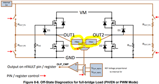

When we do the OLP, how long should we wait to get the true OLP CMP Output?
There is a description of the "record the comparator output after its output is settled."
And there seems a filter circuit at the input of the comparator.
So I assume we should wait for a certain time to get true value of the OLP CMP output.
Thanks in advance.
Hirata

    The OLP detection time will be from when the OLP diagnostics begins to when the value of nFAULT drops LOW to signal an OLP fault. We don't have this exact time specified in the datasheet because there can be many uncontrolled variables that will cause this time to differ from application to application.

    But don't you have any data? Typical is good now.
    What is the expected order of the time for the OLP completion in general? for example, "10^-4[s] to 10^-3[s] range is expected" in general or so...
    I believe this is heavily dependent on the capacitance attached to the phase node.
    Even if there is 1uF capacitance in the phase node, RC time constant is 10^-3[s] because pullup/down is 1kOhm.
    I believe 1uF at the phase node is too big for the assumption, so I guess 10^-3[s] is sufficient.
    I just want to make sure.
    To recognize which fault occurs we need to attempt 3 patterns sequentially, correct?

    This is correct. As mentioned in the DS, the user has to go through each combination and look at the comparator output to determine if there is an OLP event.

    Just got a reply from design team. Below is the response:
    "There is no de-glitch time for OLP. The timing on the output would be the same as the nFAULT time in general, determined by the nFAULT pull-up resistor, pull-down current, and the cap on the nFAULT pin."

    I think designer is answering the delay at the nFAULT portion.
    But this is not the question which we are asking. If I misunderstood please correct me.
    The original question is below.
    We need to wait some time before we judge the OLP results.
    I would like how long the user should wait in general? I understood  there can be many uncontrolled variables that will cause this time to differ from application to application. but I would like to know if you have some expectation for time to wait.

    The OLP_CMP is tied to the nFAULT pin of the device. As soon as the OLP_CMP output is settled, the nFAULT voltage will also change state. Well actually nFAULT will change states slightly after the OLP_CMP and depends on the nFAULT capacitance.
    I'm not sure if I am not understanding the customer question correctly but to me the answer I provided is reasonable. But let me know if I misunderstood the question.
