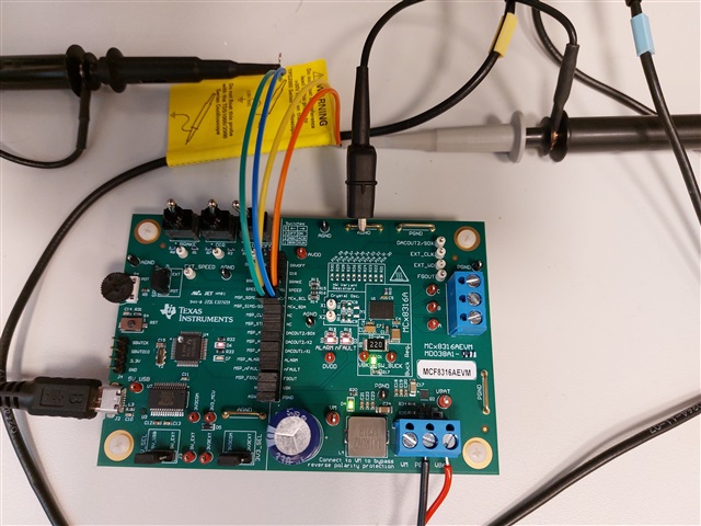

I purchased an MCF8316AEVM to see whether the MCF8316A would be suitable for use in my application. At some point while experimenting with it, it stopped working. I got the dreaded "There is an issue with the device connectivity. Please restart the GUI." while trying to read or write to the EEPROM. Thinking I had done something stupid (which I really don't think I did), I purchased a second unit. This one failed much quicker than the previous one. The last thing I remember doing before it failed was changing the setting for the IPD current limit, then clearing the motor faults. After I did this I noticed that the IPD startup procedure was taking longer than usual, so I cut power from the external supply (24 V). After the this, the board no longer functions normally.

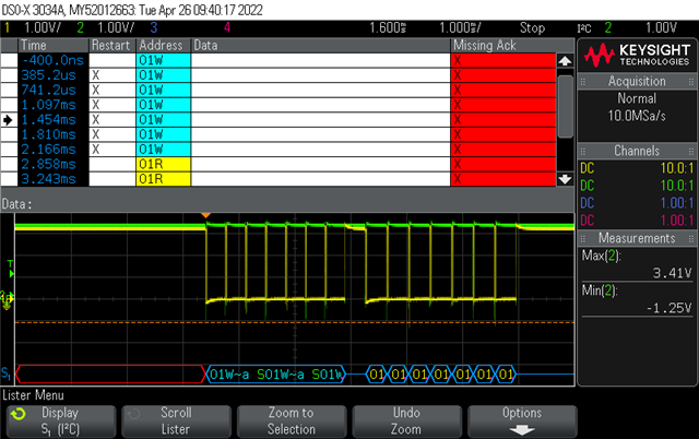

I decided to have a look on the I2C bus (on both boards) and noticed that the MCF8316A was no longer responding to I2C commands. On the second board that failed, I noticed that the nFAULT LED comes on a fraction of a second after the D1 LED. This suggest to me that the IC is mostly still working, except that it is no longer able to communicate via I2C.
