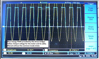

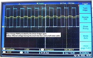

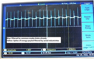

Object of my thread is a circuit which drives a small brushless-motor with low inductivity by a sinus-PWM with 42kHz. The space vector of the TMS320-µC alternates every PWM period from GND to VSS (even when the zero-vector would not alternate in idle mode - the logarithmic concept of EMC would not make the disturbing sent waves significantly smaller). The generated low-frequency is spreaded by a necessary motor-cable from 1 and a half meter length into the air. Furthermore 3 single chokes increase the inductivity of the motor coils to enable feedback of the motor state to be calculated by the µC. At one hand these single chokes, combined with capacitors, act as a low pass but on the other side the low passes can not be sufficiently dimensioned to damp the low-frequency spread-out. Also the lowpass leads to an higher wattles current - warming the single chokes.
About an answer to the following 2 questions I would by happy.
- Is shilding in combination with omitting the low-pass-capacitors better then damping by a common-mode-choke?
- Are there better alternatives to my idea of filtering by the common-mode-choke?

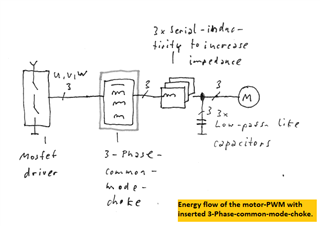

The common-mode-choke solution:
A common-mode-choke is inserted into the energy path which drives the brushless motor. The choke consists of a soft-ferrite ring (see photo) with 3x20 windings and an inductivity of 3x2 mH combined with capacitors of 3x33 nF. Like shown in the screenshots first the common mode choke filters the zero-vector of the sinus-pwm while the 3 single inductivities flatten the payload-spikes. In this guessed approach (not exactly calculated) low-frequency-EMC is damped except some remaining sinus-voltage and also the wattles-idle-current does no longer play a role.

    From evaluating your information further, I have below comments:

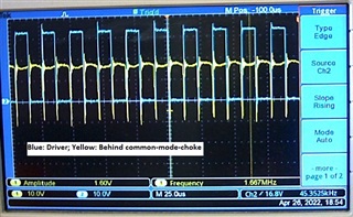

    • Generally with low-inductance motors, there is the problem of current ripple induced by PWM signals
    • looking at your scope captures,
      • it looks like the switch node (SHx) waveforms are slightly worse in the common-mode choke case, when it comes to voltage transients.
      • and the waveform with no common-mode choke, and only filtering looks to be performing well?
    • General suggestions for filtering & improving signal performance

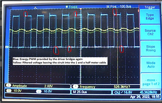

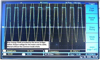

  • Hello Andrew, hello µC-developers,

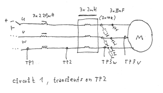

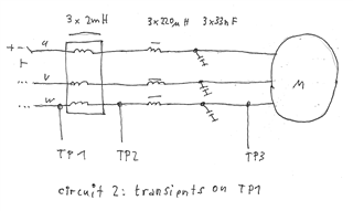

    To review my post about EMC and the common-mode-choke-trial I measured the not accepted transients with a better grounded probe and also on a circuit with a swapped order of the serial inductivities and the common-mode-choke.
    Circuit 2 shows the first trial with the bad transients:
    Circuit 2 with transients
    TP1 (Driver side)
    TP1 timezoom
    Circuit 1 with omitted common-mode-choke and nearly no transients:
    Circuit 1, common-mode-choke
    drawn but omitted for this
    measure
    TP1 (Driver side)
    TP1 timezoom
    Circuit 1 with common-mode-choke and nearly no transients plus decreased EMC on the hand-held-cable:
    Circuit 1 with
    common-mode-choke
    TP1 (Driver side)
    TP1 timezoom
    Same circuit, measured on TP2 where the transients now occur (only on passive parts):
    TP2, not damped transients
    ... same with timezoom
    TP2, transients damped
    with 3x10k resistors
    ... same in timezoom
    On the same circuit; measured voltage between two clamps of TP3, which drive the coils of the motor (a small amount of the 45kHz PWM signal still remains):
    TP3 on 3000 rpm
    TP3 on 8300 rpm
    Result: The swapped order of inductivities (see circuit 1) in the energy path moves the transients - coming with the common-mode-choke - away from the driver transistors.
