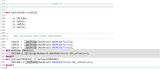

One question I've got is related to the voltage and current measurements using the ADC modules on the TMS320F2803x microcontroller. In the code I can find that the phase voltages are acquired with:
iqVaIn = _IQ15toIQ((AdcResult.ADCRESULT1<<3));
iqVbIn = _IQ15toIQ((AdcResult.ADCRESULT2<<3));
iqVcIn = _IQ15toIQ((AdcResult.ADCRESULT3<<3));
and the current with:
IDCfdbk=-((_IQ15toIQ(AdcResult.ADCRESULT4<<3)-IDC_offset)<<1);
Which to me suggests that voltages of phases A, B and C are capture with the ADC channel ADC-A0, ADC-A1, ADC-A2 and the current with ADC-A4. However, if I look at the schematic of the DRV8303EVM board (see snapshot below and attached pdf) I can see that phase voltage A is connected to ADC-B7, phase voltage B is connected to ADC-A7, phase voltage C is connected to ADC-B4 and the current of phase A (see S01 in the schematic) goes to ADC-A1.

I'm relatively new to CCS, however could you please explain me how the different ADC channels are mapped in CCS? My initial thought was that ADC-A0 (i.e. the 1st ADC channel) would be mapped to AdcResult.ADCRESULT1 but apparently I was wrong.

  • Change the ADC channel (marked RED) selection number to the related input in "f2803xidc_vemf.h" according to the hardware kit.
    AdcRegs.ADCSOC0CTL.bit.CHSEL = 15; /*Dummy meas. avoid 1st sample issue Rev0 Picollo*/ \
    AdcRegs.ADCSOC0CTL.bit.TRIGSEL = 5; \
    AdcRegs.ADCSOC0CTL.bit.ACQPS = 6; \
    AdcRegs.ADCSOC1CTL.bit.CHSEL = 15; /* ChSelect: ADC B7-> V Phase A */ \
    AdcRegs.ADCSOC1CTL.bit.TRIGSEL = 5; /* Set SOC0 start trigger on EPWM1A, due to round-robin SOC0 converts first then SOC1*/ \
    AdcRegs.ADCSOC1CTL.bit.ACQPS = 6; /* Set SOC0 S/H Window to 7 ADC Clock Cycles, (6 ACQPS plus 1)*/ \
    AdcRegs.ADCSOC2CTL.bit.CHSEL = 7; /* ChSelect: ADC A7-> V Phase B */ \
    AdcRegs.ADCSOC2CTL.bit.TRIGSEL = 5; \
    AdcRegs.ADCSOC2CTL.bit.ACQPS = 6; \
    AdcRegs.ADCSOC3CTL.bit.CHSEL = 12; /* ChSelect: ADC B4-> V Phase C */ \
    AdcRegs.ADCSOC3CTL.bit.TRIGSEL = 5; \
    AdcRegs.ADCSOC3CTL.bit.ACQPS = 6; \
    AdcRegs.ADCSOC4CTL.bit.CHSEL = 2; /* ChSelect: ADC A2-> Low Side DC Bus Return Cur.*/ \
    AdcRegs.ADCSOC4CTL.bit.TRIGSEL = 6; \
    AdcRegs.ADCSOC4CTL.bit.ACQPS = 6; \

  • As mentioned above, please change the using ADC channel marked RED according to DRV8303EVM board. Just tell you how to change the ADC channel in the example code in controlSUITE you used, it's not the right value for your board.
