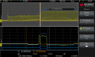

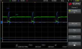

For example, going from "stop" -> 4, with no load attached (only testing signals on the oscilloscope), this change ocurrs well, but sometimes a "gate drive fault on the B low-side MOSFET" occurs. When the change is 4 -> "stop" it aways leads to the same fault (gate drive fault on the B low-side MOSFET) , as registers shown below:
REG_0x00 0x500
REG_0x01 0x4
Below, a oscilloscope print of the MOSFET's GHC and GLC signals, as well as Phase C and INHA's PWM signals, where all reference gnd are at the same place as "blue gnd":
Some importante data:
Voltage: 12v
F ~= 195kHz
Mosfet: IRFS7530 (Qg = 236nC typ.)
If possible, I would like to be enlightened about the following questions:
1- Is this a high Mosfet Qg so that the fault occurs due to this? How to solve this problem? Is it needed to change the mosfets?
2- When transitioning between states on "synchronous 1x PWM", it's expected to be generated a fault? If yes, should we disable "Gate drive Fault" (address = 0x02h)?
3- What is the maximum recommended Qg and Qgs for the stable functioning?
4- Phase C and GHC lower level are both below GND. Is it normal? What does it means?
5- The GLC trace when goes low decays slowly, is this abnormal? What is this ripple at the "low" period?
Best regards and thanks for your help!
  • Hi Emanuel,
    Before answering the questions, first thing we always look for when someone reports a "Gate Drive Fault" is to check the IDRIVE settings. I can see you're using the max gate current settings for switching your MOSFET! The "FF" corresponds to 1-A source and 2-A sink gate current for your MOSFETs.
    Using too high of an IDRIVE current will slam your FETs on and off really fast leading to potential gate drive faults as inductance in the gate drive traces can generate spiking, transients, or even damage at GHx/GLx. Use a lower IDRIVE setting based on this FAQ: https://e2e.ti.com/support/motor-drivers-group/motor-drivers/f/motor-drivers-forum/796378/faq-selecting-the-best-idrive-setting-and-why-this-is-essential
    Aaron
  • I've changed to 300mA (source) and 600mA (sink) and it stopped getting fault. In addition, when using this config with synchronous 1x PWM as shown below:

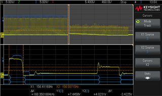

    Setting F~=130kHz, it seems impossible to reach the 100% duty or even 95%, and for some F, it's impossible to reach lower than 10% duty, although the chip delivers the correct waveforms as shown previously. Is it expected? How the register setting can vary the possibles duty-cycles (and how to measure it?)?
  • Hi Emanuel,
    I am glad to hear that reducing the IDRIVE was able to resolve the GDF issues!
    Could you provide a waveform showing the 3 phase voltages in addition to the INHA input PWM signal using F = 130kHz? Could you adjust the timescale so that it shows about 2-3 input PWMs on 1 waveform?
    Anthony Lodi

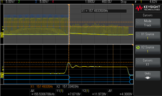

  • Hi Anthony,
    I've done some measurements to show you the changing accuracy of the PWM duty, as well as the difference from SW to real test. For that, I have some questions:
    1- Looking at the 3 images below, with respect to each configuration specified in each pic, only the last one corresponds to signals with drastically lower ripple, compered to the other two images. Does it means the third image is the best in terms of stable functioning? Did I find the optimal current for the mosfets I am using? (I took the advice about the link you've sent to tune the GHx and GLx).
    2- Using a F~=27kHz and increasing PWM duty, its possible to vary duty from 10% to 90% with no problems, with no big difference, as shown below. At 10% duty, the GHC trace presents a thin on-time period and the falling edge of GLC trace shown is extended and apears to limit lower duty-cycles: is it possible to sharp this slope?. At 70%, the rising edge presents a attenuation. What causes this attenuation? Is that a problem at all?
    3- At around 54kHz, the 70% duty selected turns to be 63,2%. Is that a resonable value? What could be a possible explanation for this difference?
    4- At around F=107.5kHz, the intended 10% of duty does not turn to be efficient, so that the GHC does not rise. Why is that? Is a chip limitation? If not, what configurations could I use to secure proper functioning at this frequency?
    In addition, for a software 70% duty leads to a 55.9% duty in real test. Is this difference expected for this frequency?
    The chip has been showing unconstant duty correspondency to real test, indeed, as 93% of duty leads to 94% duty during real testing yet at around F=107.5kHz.
    5- Looking at this images, for what you know, is it possible to say they show an expected behave of the chip?
    Best regards, and thanks for your help!!
  • Hi Emanuel,
    Based on the Qg of the MOSFET you are using (236nC), This will limit the max PWM frequency that is recommended to use. Since the charge pump has a limited supply of charge, the more frequently you switch the MOSFETs the more demand that will put on the charge pump. If you are using trapezoidal commutation, the formula to calculate the average gate current that is needed to switch the MOSFETs at a particular rate is shown below:
    So with a Qg of 236nC and a fPWM of 130k Hz, the average charge pump current would be 236nC x 130k Hz = 30.68mA which is higher than the average charge pump capacity of the DRV8353. I would recommend using an fPWM of about 80kHz or lower if you are using trapezoidal commutation to achieve an average gate drive current of less than 20mA. Keep in mind that calculation is done based on the average Qg value, the datasheet shows that the Qg value can be as high as 354nC which will reduce the max allowable fPWM value even more.
    In order to prevent shoot through on the MOSFETs, the DRV waits until the VGS voltage drops to about 2V before inserting the deadtime and then switching on the other MOSFET. As a result, this will effect the actual duty cycle that is observed based on how long it takes to discharge the gate voltage.
     I would definitely agree that the gate current in the first two waveforms is too high for your system to handle as is evident by the amount of ringing on the gate and sources, and that the third waveform is much better in regards to ringing issues. There are likely some improvements that can be made on the layout to reduce the susceptibility to ringing on the MOSFETs by widening the gate traces (at least 20 mil traces) and ensuring that the gate traces are as short as possible to reduce parasitic inductance. Additionally, ensuring that the SHx switch node is a large polygon will help improve ringing as well. Some helpful layout best practices can be found in the Best Practices for Board Layout of Motor Drivers app note.

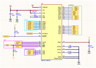

    Would you be able to provide your schematic to see if there is anything from a schematic perspective that could be a contributing factor?
    Anthony Lodi
  • Hello Anthony,
    here is the schematic:
    Any advice is welcome!

  • Hi Emanuel,
    Thanks for the data! I don't see anything at least initially from the schematic that is problematic. Let me follow up with you in regards to your questions in more detail next week.
    Anthony Lodi

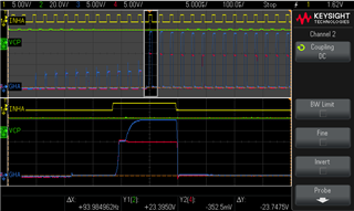

    Thanks for your response. Could you provide a plot showing the high side gate voltage as well as the high side source voltage on the same plot showing the behavior with the gap? I want to see if the drop in the SHx voltage is a result of the MOSFET partially shutting off.
    Anthony Lodi

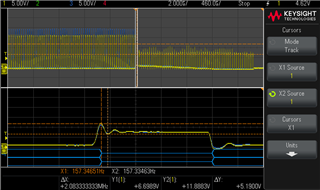

  • Hi, Anthony.

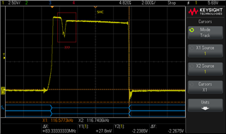

    Below there are some images from my oscilloscope, showing the trapezoidal waveform:
    Zooming in the theorical falling edge of the trapezoidal waveform:
    1- A bit of ringing appear over SHx and GHx. Futhermore, SHx follows GHx so that Vgs = 0 (see below). I am assuming this is expected because during the shown period this half bridge remains unconnected, is that right?
    2- According to #1, here it's possible to see the difference to the previous image in respect to the Vgs voltage. The Vgs level should be grater rather than ~5v, as it seems by the follwing pictures, right? If so, why is that so low? And why the SHx trace goes high even during GHx = SHx (right after the rising edge)?
    3- Is it correct to say the Back-EMF on this phase is equal 1.70v, at this specific point, as shown by the cursors? (explaining: at this point the half bridge shown is diconnected, and the other two phases are shorted to gnd, which leads me to think this abrupt level difference shown is caused by the Back-EMF on this phase).
    4- Here, a couple of pictures evidentiating a notch dividing the on-time baseline. Why is this occuring? The motor is running on a open-loop code, where the commutation can possibly occurs in a non desired moment, which could explain this pattern shown, specially at the on-time falling edge, does it make sense?
    Regards!
  • Hi Emmanuel,
    You are correct that the difference between the SHx voltage and the GHx voltage should be more than 5V, it should be closer to around 12V. What is your VM voltage? Could you provide a waveform showing the same signals (GHx and SHx) while also plotting the VCP to ground voltage as well as the INHx input? I want to see if the charge pump is only about 5V above VDRAIN or if the VCP voltage is 12V above VDRAIN but the gate is not going up to VCP voltage. Have you tried these measurements on a brand new board with a brand new DRV? I want to rule out the possibility of the device being partially damaged, especially if this was the same device/board that you initially used the Max IDRIVE settings on.
    I suspect the reason that the SHx voltage is going high even though the GHx-SHx voltage is 0V is because there could be some small leakage current that is flowing back up to the supply through the body diode of the high side MOSFET which is pulling the source voltage up to the supply.
    Regarding question 1, GHx will follow SHx when the phase is in Hi-z mode such that the GHx-SHx voltage stays at 0V to keep the MOSFET off.
    Anthony Lodi

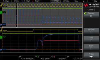

  • Hi, Anthony,
    My VM = 15V, which leads to a VCP of around 25.5V. As shown below, my VCP is around 23.4V, with 0x03h = 0b0001101101000100 and 0x04h = 0b0001101101000100
    All four images were taken with no motor attached.
    The system in use is the same as the previous questions, the chip was never changed.
    (Fig. 1)
    Below, the register set is the same other than 0x03h = 0b0001101110111011 and 0x04h = 0b0001101110111011. In addition, VCP keeps same value as in Fig.1:
    (Fig. 2)
    Although the ringing on Fig.2 is greater than the one on Fig.1, the rising/falling edges were sharpened. Despite all of this, why do the diference between GHA and INHA increases in the second fig., considering these are the only changes?
    Regards!

  • Hi Emanuel,
    Since you are using the same chip/system in all the tests, I suspect there could be some slight damage that could have occurred since you have operated this particular chip using the max IDRIVE setting in the past. Because of the Qgd of the MOSFET you are using, There is a possibility that the ringing caused by using the max IDRIVE setting could have violated some pin ratings that may have resulted in some slight damage that is resulting in the device having a harder time keeping the gate of the MOSFET on which could be why you are only seeing the gate to source voltage turn on to about 4V using an IDRIVE setting of 300mA/600mA. If you could use a brand new chip and preferably a new PCB and retest whether the gate to source voltage of the high side MOSFET is able to turn on to a voltage of around 10-12V with an IDRIVE setting of 300mA/600mA that would be helpful in eliminating the potential of the issue being a result of damage on the device or board.
    Anthony Lodi
  • Hi, Anthony.
    I've changed the chip for a brand new one, which works fine.
    Also I discovered that the previous error was issued only in the phase A, not affecting phases B and C, but now with the new chip the error is gone.
    The images below refers to VM=15 and Max IDRIVE settings are 150mA (source) and 300mA (sink), for all phases:
    1. Below, zooming in the waveform, we are able to see some areas where SHA and GHA are equal, at the begining of the high cycle. During this short period, Vgs = 0: thus, is SHA high or HI-Z? Is it expected?
    2. Some places presents a slit on the high plateau, what does it means and why is it present only on some cycles?
  • Hi Emanuel,
    I am glad to hear that changing the DRV fixed the issue!
    1. When SHA and GHA are equal as shown in the waveforms you provided, the MOSFET is off and the phase is in Hi-Z mode (both MOSFETs of half bridge A are off). The SHA voltage goes high due to some leakage current in the system that is flowing through the body diode of the high side MOSFET, pulling SHA to VDRAIN + the voltage across the body diode. Once the VGS voltage is enough to turn the MOSFET on, current will instead flow from the drain to the source through the MOSFET.
    2. In the case where the voltage rises and then drops prior to the MOSFET turning on, it looks like the current that is being pulled up through the high side body diode eventually dissipates and the voltage is no longer being pulled up through the body diode so it drops, then once the MOSFET turns on the SHA voltage rises again. In the cases where the voltage stays pulled up until the MOSFET turns on, that indicates that the current that is pulling up the high side source through the body diode is high enough such that it doesn't fully dissipate by the time the MOSFET is turned on.
    Is this behavior seen on all of the phases? Or just on phase A? If it is just on phase A, it could be that some parasitics in the layout for phase A that could be contributing. For some insight on motor driver layout best practices, you can check out the attached document.
    Anthony Lodi

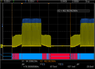

  • Hello,  Anthony.
    It occurs in all phases. Thus, this afirmative lead us to a previous situation that might be related to it:

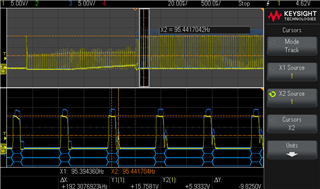

    During open-loop operation, the trapezoidal waveform is as shown:
    The image shown below refers to the closed-loop operation (with hall sensors) in which: the left-side trapezoidal waveform's slope is not as evident as the right-side one:
    Can this occur due to misalignment between hall effect sensor and motor windings? If not, what is this caused by?

  • Hi Emmanuel,
    You are correct that a misalignment in the hall effect sensors and/or motor windings can lead to less symmetrical back-EMF waveforms. If you feed the hall signals back to the MCU you may be able to implement some delay/advance in the commutation to help produce a more symmetrical back-EMF.
    Anthony Lodi
