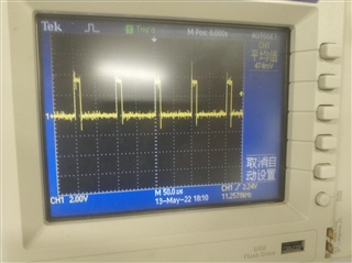

When output PWM, after connecting to the motor the output side shows the following waveform:
The customer would like to know what's the reason for that. Could you help check this case? Thanks.

    1. Was this waveform GH_x with respect to GND, or SH_x with respect to GND?

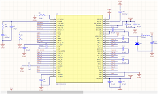

    5. Can the customer share their schematic?
    The oscilloscope probe is grounded to GND with respect to the PVDD and the oscilloscope probe input is connected to SH_x.
    And during the measurement, if the B and C phase lower bridge switch tubes are always kept on, does the time input of the A-phase input PWM waveform lower bridge switch tube input signal turn off some of the time, causing some kind of protection?

    Thanks for the response! Would the customer be able to provide a waveform showing the GHx and INHx signal in addition to the SHx signal for the issue that they are seeing? I want to see if the issue is due to the gate not staying on or if there is a different reason.

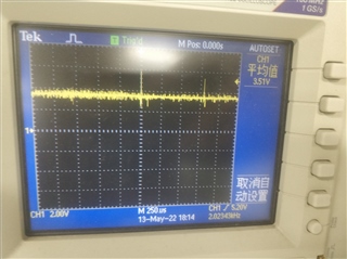

    The GH waveform of the upper bridge arm of the A-phase input PWM is as follows:
    The INH waveform of the upper bridge arm of the phase A input PWM is as follows:

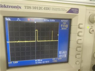

    Phase B leads to the GL waveform of the lower bridge arm is as follows:
    Phase B leads to the INL waveform of the lower bridge arm is as follows:

    Thanks for the waveforms! I am seeing some concerning spiking on the input waveforms, and it could be that this is resulting in some brief parasitic turn on of MOSFETs that should be off. Are the inputs being generated by a microcontroller? Are there sources of noise that would be causing these spikes?
    There are limitations in being to analyze the waveforms when the customer is only using 1 probe. It is best to have multiple signals on the same waveform to compare those signals in real time, such as GHA and SHA on the same waveform, and INHA and GHA on the same waveform. If the customer has the ability to use 2 probes, that would help in better analyzing the waveforms to have multiple signals on one oscilloscope capture.
