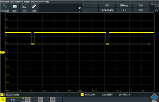

    The R140 and R141 are the thermistors. Customer tried to remove these two thermistors and change the motor load to resistor load(2.5ohm/300W). But the SHx/SHy still not equal to 1/2 PVDD. You can find the waveform as below. Their open load diagnostic strategy is periodically 3s active mode, 300ms offline open load detection. We can see the SHx/SHy is increasing when PVDD increase from 9V to 12V. But the SHx/SHy keep the same voltage when PVDD increase from 12V to 15V.
    Do you have any other suggestions? Or could you please share our waveform for offline open load detection to show the 1/2 PVDD when there is no open load fault?
    This project is going to production right now. Appreciate if you can give some comment by today. I will have meeting with customer late today.
    PVDD=9V, SHx/SHy=~4.5V
    PVDD=12V, SHx/SHy=~5.3V
    PVDD=15V, SHx=SHy=~5.3V

  • Ethan,
    Morita-san is out of the office today.
    Are they sure they are enabling BOTH the HS and LS current sources as shown in the figure?
    Ryan
  • Hi Eathan,
    As discussed separately, 1/2PVDD is not correct information. SHx voltage is not defined in this situation. Material will be updated.
    regards
    Shinya Morita
