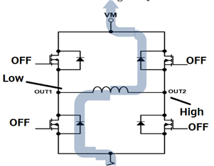

My customer is evaluating DRV8244-Q1 with the EVM.
Then they are facing a problem for the brake operation with a brushed DC motor.
According to the datasheet, the required IN1 and IN2 pattern in the PWM mode for brake operation is opposite, 0/0 for production sample and 1/1 for pre-production sample.
I’m not sure which sample is put on the EVM they are using, but they tested both IN1/IN2 = 0/0 and 1/1. It means they have tested both OUT1/2 = Hi-Z/Hi-Z and HIGH/HIGH.
Then then couldn’t see so much difference in both 0/0 and 1/1 setting and both were not like a brake operation. The motor continued to spin by its inertia in both setting.
So they couldn’t feel so-called brake operation with both setting.
DRV8244-Q1 uses high-side recirculation.
Then they tested with other motor driver IC using low-side recirculation like DRV8701(EVM) and others.
With these devices, the motor stopped soon after setting LOW/LOW outputs.
Then they have 2 questions.
1.
Regarding the brake effect, is there so much difference between high side recirculation and low side recirculation?
2.
They couldn’t feel brake effect in DRV8244-Q1.
Do you know the reason?

    I do not expect "Brake" is such a weak by HH braking. So I guess something is happening.
    -Is customer using SPI variant? If so, could you read DEVICE ID? I know truth table has error in pre-production sample not only PWM mode, but others. So better to identify which sample customer is evaluating.
    -Is there possibility some fault condition (e.g VMUV, TSD) is happing? Then output will be HiZ. Monitoring nFault or read FAULT_SUMMARY(address 0x01h) is the way to monitor fault flag.
    -If customer can measure OUT1 and OUT2 at the same time, it could tell whether both High(braking) or HiZ. If Hiz(both OFF), one of output should be Low.

    Thanks for your support. We found the root cause.
    They also used DRVOFF pin to control the status and due to this wrong DRVOFF signal, both cases were HI-Z/Hi-Z pattern.
    They changed the input signal pattern with DRVOFF=0 and confirmed it worked well.
