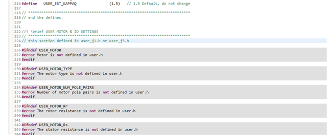

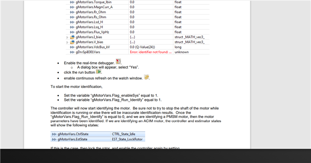

  • I am currently running lab2a and trying to set the gMotorVars.Flag_enableSys = 1, but it just defaults back to 0 when I set it in the expressions.  Is it supposed to be set in code or should you be able to modify it in the expressions? So I set the enableSys to 1 and press enter and it just goes back to 0.  Then I set the run_identify and that stays at 1.  However, it says the shaft will spin, but nothing is spinning while trying to identify.  I do see some variables lighting up yellow every so often, so maybe it is identifying something.
    Also it says to set the params in user.h, but it won't compile when I do that.  I am assuming they are set in user_j1.h as it says they are defined in one of those header files?

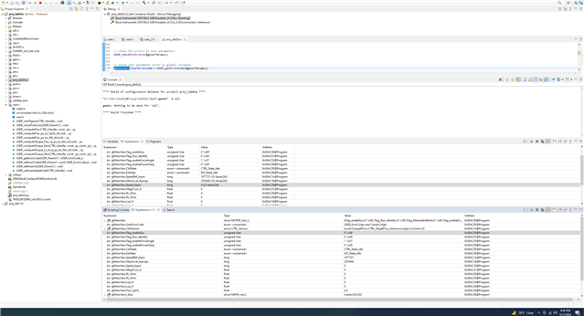

  • Any changes on the example code except the motor parameters? Do you change the PWM frequency? What's value of the gMotorVars.UserErrorCode variable by following the guide to add the monitoring variables in the CCS debug window?
    Seems like the USER_MOTOR_MAX_CURRENT is set too high and greater than USER_IQ_FULL_SCALE_CURRENT_A. You should set USER_IQ_FULL_SCALE_CURRENT_A according to the motor and inverter, and less than USER_IQ_FULL_SCALE_CURRENT_A.
  • No I did not change anything in the example code except for the motor and params. I didn't change the PWM frequency.  Ok should the USER_IQ_FULL_SCALE_CURRENT_A be the same as the peak current?  I just used that blank template described in the instalab 2a and only changed the max current.
  • Set the right USER_MOTOR_MAX_CURRENT. The USER_IQ_FULL_SCALE_CURRENT_A  can be between 0.5*USER_ADC_FULL_SCALE_CURRENT_A and 1.0*USER_ADC_FULL_SCALE_CURRENT_A that depends on the hardware kit. You don't need to change the USER_ADC_FULL_SCALE_CURRENT_A and USER_IQ_FULL_SCALE_CURRENT_A   in the example code.

  • 1. Run the lab02a/b/c to identify the motor without load.
    2. As described in the lab guide, import the related monitor variables into the CCS debug window, some of the variables should be IQ24 format, but the variables you mentioned above are floating-point type. Please don't change the number format of these variables to decimal.

    #if (USER_MOTOR == Nanotech_DB87M01)
    #define USER_MOTOR_TYPE MOTOR_Type_Pm
    #define USER_MOTOR_NUM_POLE_PAIRS (4)
    #define USER_MOTOR_Rr (NULL)
    #define USER_MOTOR_Rs (NULL)
    #define USER_MOTOR_Ls_d (NULL)
    #define USER_MOTOR_Ls_q (NULL)
    #define USER_MOTOR_RATED_FLUX (NULL)
    #define USER_MOTOR_MAGNETIZING_CURRENT (0)
    #define USER_MOTOR_RES_EST_CURRENT (1.0)
    #define USER_MOTOR_IND_EST_CURRENT (-1.0)
    #define USER_MOTOR_MAX_CURRENT (10.77)
    #define USER_MOTOR_FLUX_EST_FREQ_Hz (20.0)
    and everything worked fine.  The motor shaft rotated and all the values got identified.  I changed them back from float to default which they came out to be

    Then when I go to run lab2b and run it the same as lab 2a, when I come to setting gMotorVars.Flag_enableSys = 1 in the expressions window, it just immediately default back to zero.  I thought this was happening like when I had the max current set to high.
    The only other warnings that I could see in user_j1.h were for USER_IQ_FULL_SCALE_VOLTAGE_V and the equation below is true
    USER_IQ_FULL_SCALE_VOLTAGE_V > 0.5 * USER_MOTOR_MAX_CURRENT * USER_MOTOR_Ls_d * USER_VOLTAGE_FILTER_POLE_rps.
    So this should not be the cause of the roll over.  And my USER_MOTOR_MAX_CURRENT is set at 10.77 way below the 24.0 of USER_IQ_FULL_SCALE_CURRENT_A.
    So I am not quite sure why this is happening.
    Am I not supposed to enter the values found into the motor params in the user_j1.h file?
