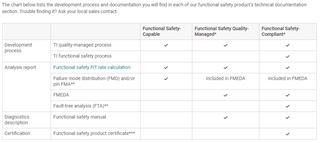

Hi Eason,
For a high-level answer:
For more info, this webpage will be a good general resources to explain the differences: https://www.ti.com/technologies/functional-safety/overview.html
Let me know if this resolves your question. Thanks!
