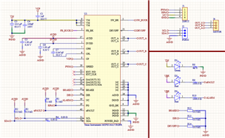

    The new board for our application is designed without microcontroller for I2C command. Now, I have a doubt will it work or not. The schematics is given below,
    Can you just check and let me know?

    Will you be able confirm my schematics?
    Sujeesh
  • Sujeesh,
    Here's my feedback.
    1. Rbk and Cbk should be populated across SW_BK and GND.
    2. BRK can be pulled to GND via 10k resistor if unused.
    3. DIR can be connected to AVDD via 10k resistor if unused.
    3. DRVOFF pin should be pulled to GND.
    Vishnu
  • Hi Vishnu,
    Thanks for the feedback.
    1.  22 Ohm Rbk and 22uF Cbk are used
    2. BRK is connected to AGND via 10k resistor (mentioned in the previous schematics)
    3. DIR  is connected to AGND via 10k resistor (mentioned in the previous schematics)
    4. DRVOFF is connected to AGND via 10k resistor (mentioned in the previous schematics)
