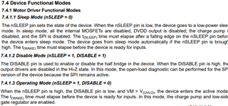

If we use DRV8873-Q1 and control the motor through SPI register (SPI_IN = 1b), then we can leave the EN/IN1, PH/IN2 pins open because it has internal pull down, correct?

Hi Hirata san.
Yes, it is correct.
And recommend to set Disable pin =H first during wake up sequence. After SPI configuration is done, make Disable pin=L low to enable output.
Please refer datasheet 7.4
