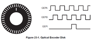

eQEP block is used to measure the angular position in the microcontroller. It uses the
voltage on the free phase line to detect the position.
If above statement is correct, then addition is:
We intend to use a hall sensor MT6825 from MagnTek whci gives output as absolute algular position in the form of 12 bit PWM or 18 bit SPI with available communication interface of 3 wire SPI/4 wire SPI. Can the eQEP take the sensor output as input to determine the agular position accurately?

  • The EQEP module is used for direct interface with a linear or rotary incremental encoder to get position, direction, and speed information. The signals from the encoder are as the attache picture which will be connected to the pins of the EQEP module.
    Yes, you can use the EQEP to sense the PWM signal to calculate the rotor position.
    You may use the SPI to get the position data from the sensor directly.
