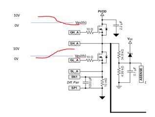

    Can you confirm if your GHx/GLx waveforms are having a shoot through event like below?
    One thing we found in some code is that with InstaSPIN-FOC is that the BOOSTXL-DRV8301 does not turn on the LS FETs first every time the 50% PWM initialization sequence is started. With DRV8301 being a bootstrap based device, the expectation is to turn on LS FETs to charge bootstrap cap first and supply current to HS FETs. The algorithm intermittently turns on the HS FETs first, and when those are turned on first, you may experience a false OC events due to VDS marginally exceeding OC_ADJ_SET threshold value (~400ns after INHx = high, deglitch time is 400-500ns).
    Does the event above seem pertinent to your situation?

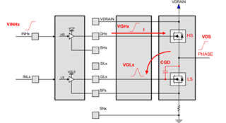

    1) The MOSFET Qgd values you shared are very small, so increasing the gate resistance can help. I do not know how the gate current is when 27 ohms is introduced, but considering the Qgd of the MOSFETs are 4.5nC and 1.4nC respectively, this means the gate current shouldn't be more than 14mA worst case (1.4ns/100ns) to slew the VDS MOSFET voltage faster than 100ns. Increasing the gate current may help more if you know that a shoot through condition is not happening causing the short condition.
    2) To confirm how the overcurrent condition is occurring, can you confirm using an oscilloscope whether:
    • The VGS voltage of the high-side MOSFET (GH_x-SH_x) and the low-side MOSFET (GL_x-SL_x) is on at the same time (VGS higher than the FET threshold voltage)? I do notice the Vgs(th) values for both these FETs are very low (~1-2V), so if the gate drive current is too low, then there is likely shoot through current occurring. Adding additional MCU dead time at the inputs or increasing the resistance at the DTC pin will be helpful.
    • When the gate drive current is too high and you're switching a large amount of current through the MOSFET, it is possible that the motor voltage can couple into the low side gate voltage. Since the Vgs(th) values for these FETs is small, any spike on the low-side VGS voltage can cause the same type of shoot through condition to occur and cause damage to the MOSFET.

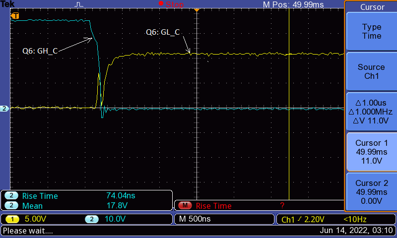

    I've attached scope captures of GL and GH on Q6. The names of the files speak for themselves. In the closeup, it's pretty obvious that both gates are being turned On, at least partially, at the same time. These captures were obtained in the first 5 seconds or so after activating the firmware (Flag_Run_Identify & Flag_Enable_Sys both High). I played around with one board a little too long, and burned another FET (there's also a little square burn mark on my left index finger), so I suspect that the simultaneous on-time gets worse as time progresses. A couple of thigs that strike me as odd:
    GH has a much higher amplitude than GL, and

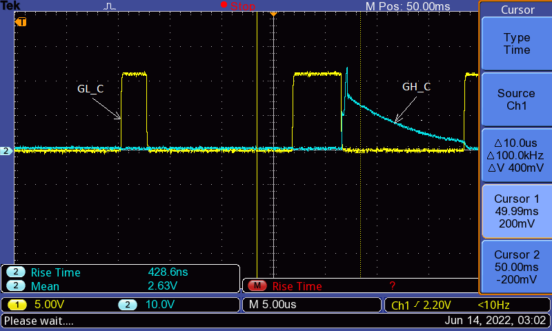

    This is because when you turn on GH_x, it needs to be 10-V than the motor voltage which is at the high-side source pin (SH_x), so our DRV8301 part turns on GH_x to be SH_x + 10V, hence your supply voltage is 24V to GH_x with respect to GND turns on to 34V so that the high-side Vgs (gate-to-source voltage) is 10V.
    See below when you switch the GH_A on, the gate driver turns on GH_A so that it increases to 34V while SH_A increases to 24V to the Vgs of the HS FET's gate increases to 10V.
    Now let's look closely how the FETs are turning on to see if they're turning on at the same time.
    With no load, we see that GL_C is turning on at GH_C is turning off. It's hard to tell looking at just GH_C itself whether the high-side FET is actually on because we need to look at GH_C - SH_C (gate to source voltage) to see if Vgs < Vth, but knowing PVDD=24V and the low Vth of the FETs, it is very likely that these are turning on at the same time every PWM cycle, which will result in a lot of current flowing through the FET and excessive heating.
    To resolve this, I would add at least 250ns of dead time as you mentioned. You can do this either by adding the 250ns at the MCU inputs (INH_x/INL_x), or by increasing the DTC resistor to a value that corresponds to 250ns, so the 75kohm resistor should be fine.

    Given what's happening, I'd say they're almost certainly turning On at the same time.
    I tried a 68k resistor at DTC, and saw the following at the FET gates (Blue is GH_C, and yellow is GL_C):
    Looks like the duration of the overlap of the extra GL_C pulse and the GH_C was decreased from 200ns to 80 ns, and the amplitude of that extra pulse is smaller (probably just this one instance - I think I saw others that were higher than the one pictured here).
    I didn't like the looks of it, though, at the time, and was hoping to completely eliminate any overlap, so I increased the DTC resistor to 120k, which resulted in an overlap of only 30ns, as shown below:
    The amplitude looks like enough to activate the gate, but it's for a much shorter period.
    Unless you have any other suggestions, I'm going to try and let this run for an extended period, and see whether it blows the FET again.
    If it works, that's great - we can at least do some testing with these boards.
