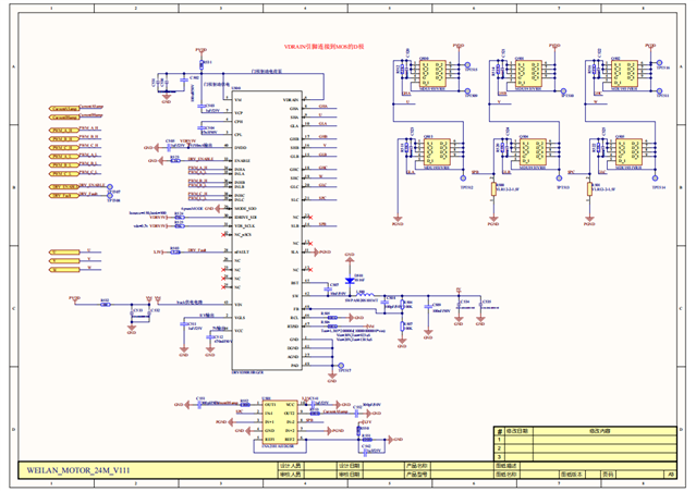

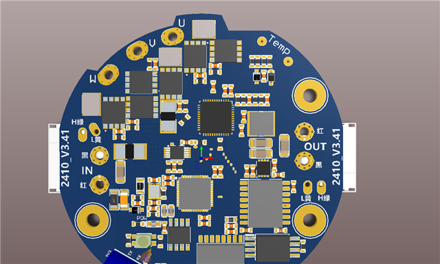

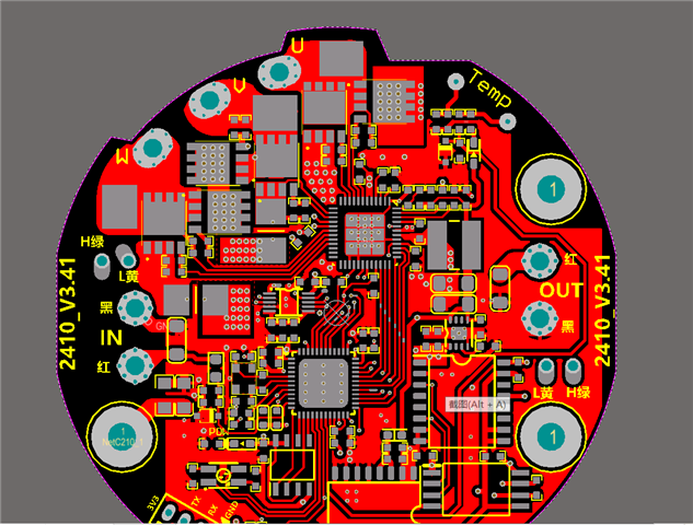

 Dear
At present, 12000 pieces are produced, and about 10 pieces are defective, and they are still being reported recently.
Poor performance: the motor drive function cannot be used, and most of them are hot. VGLS (Pin2) and GLA, GLB and GLC are slightly short circuited. The normal impedance is above 100k, and the error is abnormal. Some are as low as 80O, and some are at 2k.
Please refer below SCH and PCB.
