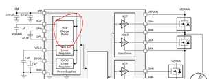

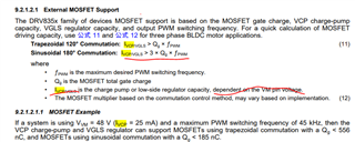

1: in the datasheet  Page68
     Ivcp is dependent on the VM pin voltage, but I didn't find some parametre of Ivcp value ?
2:   Trapezoidal 120° Commutation: IVCP/VGLS > Qg × ƒPWM
     while Sinusoidal 180° Commutation: IVCP/VGLS > 3 × Qg × ƒPWM
      the above formula , how to get it ??
and  also  whether or not  IVCP/VGLS   is  the mean value of the Tpwm ?
3: Page 70
   when calculate the Pvcp ,PVCP = IVCP × (Vvm + Vvdrain) ,why add the  Vvdrain ??

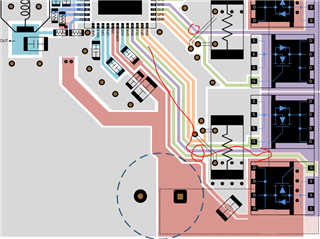

4:about the PCB  Layout
     does it matter when the GHA-SHA and GLA  signal  flow through the sense resisitor ?  does it interfere the small current sense signal?
