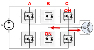

Phase C high-side FET is on when align is on, and phase B low-side FET is on. Current should be phase C in, phase B out? Is the green highlighted part written wrong?
Could you help confirm it? Thanks.

Cherry,
What is mentioned in the datasheet is correct. When phase C HS FET and phase B LS FET are ON, current will flow out of Phase C and into phase B as shown below
