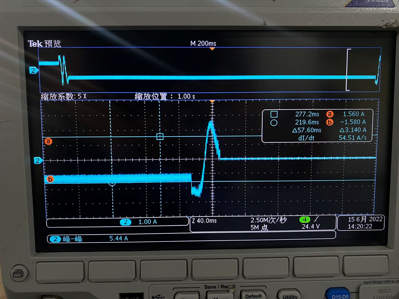

DRV8711 TORQUE 0?
After we set TORQUE to 0 now, IFS current is not 0mA.

hi Pablo:
The register configuration information is as follows,
Register 1: 0x05 of low byte other default values
Register 2: 0x32 other default value of low byte
The theoretical current is 3a*2%=60m, and the measured current is 900mA.
Hey Kevin,
Just to clarify - is this happening when you're sending steps to it with the TORQUE value set to 0? Or is it having a holding current of 900mA when it should have 60mA?
Also, is this happening on your own circuit or an EVM? If it's your own circuit would you mind posting a schematic diagram for us to look at to help troubleshoot?
