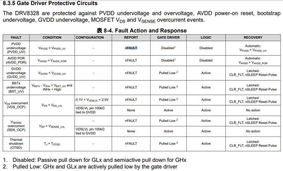

Hi team,

  • Hi NY,
    1. nFAULT itself does not have a deglitch time as it is not a fault monitor
      1. the various fault types reported by this nFAULT pin, however, may have deglitch timers depending in the fault category
      2. see this example below from the datasheet for BST_UV type fault deglitch time
    2. As an initial resource, here is an app note explaining the gate charge impact on average gate-drive current
      1. Smart Gate Drive: https://www.ti.com/lit/an/slva714d/slva714d.pdf
      2. DRV835x datasheet also has a section on this: https://www.ti.com/lit/ds/symlink/drv8350.pdf
        1. not the same device, but some useful info to consider on page70, section "9.2.1.2.5 Single Supply Power Dissipation"
      3. we will follow up with the team to see if there's a calculator resource we can share for this device
    Andrew

  • Hey NY,
    I just wanted to provide some information on the power calculation. The DRV8328 datasheet section 10.3.1 shows the formulas needed to calculate the power dissipation based on the loss type.
    IGVDD = number of MOSFETS switching * Qg (total gate charge of the MOSFET) * Switching frequency.
    I hope this offers some clarification. Please feel free to reach out with any questions you might have.
