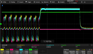

we have a problem with current flow to motor under special conditions.
We use the 1 PWM mode.
We have 2 Problems.
At Startup a high current flow, so that the voltage drops .
Green 24V form the powersupply.
The other signal are the current flow trough the coils.
This happens sometime after enable the motordriver.

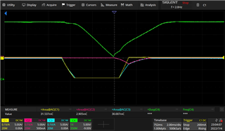

The scond problem is, that if we stop the motor physicaly,
a high dc current is flow through the motor
I think that is because of the simple statemachine inside of the controller.
If there is no more hallsensor signal, it stays in the statmachine within the block commutation.
Is this right?

    Your IDRIVE setting is quite high. Based on the Qgd of the FET you've selected, your rise time at the gate of the FET (trise) is 8 ns. We don't recommend trise to be faster than 100 ns. The current setup may cause coupling of the high side FET source into the gate of the low side FET, turning the low side FET on temporarily and causing a shoot-through event. This will cause excessive current draw from the power supply which could lead to the dip seen in the power rail. Monitoring the FET gate voltages on one phase of the motor with an oscilloscope is a good way to see if shoot-through is occurring.
    We recommend lowering your IDRIVE to 50 mA. This will keep a fast trise time of about 100 ns and prevent shoot-through events.

    If the motor is held in position physically (0 rpm) the internal state machine will react in the way seen in the oscilloscope trace. Current will increase to compensate for the increased torque on the motor. The output phase traces are what we would expect to see given the information provided.
