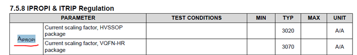

In the datasheet we only list the typ. value. My customer wants to know the min. and max. value. Could you please tell me that?

Hi Sherry,
AIPROPI varies by output current level, we have 3 conditions for this SPEC. Please refer following the scaling factor error SPEC for min/max estimatinon.
regards
