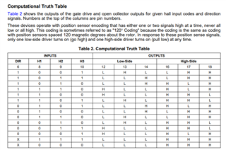

Also, as highlighted above, what really means by "transition"? As I understand it, it refers to the steps/position of rotor to complete the revolution, correct? Or, are the transitions related to the Tachometer? The Tachometer on this chip triggers whenever there's a change in state for the Hall effect sensors.
In the current system of my customer that is 6 because there are only 3 hall effect sensors, but in the Datasheet it mentions there could be 6 transitions or 12 transitions, which deters me from thinking it's related to the tachometer.
    The tachometer triggers when there's a rising or falling edge, so this is likely the "transition" the datasheet is referring to. If there are 3 hall sensors, then there is 6 total transitions for a DIR direction state.
    My guesses for the 12 total transitions could be:
    1) If the DIR direction state is the opposite and this the motor spins in the opposite state, then this might be the other 6 transition making 12 total transitions in the motor operation, similar to Table 2:
    2) If the Hall sensors also placed 60 electrical degrees apart, then this could be 12 total transitions.
