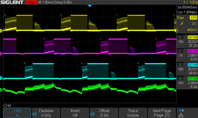

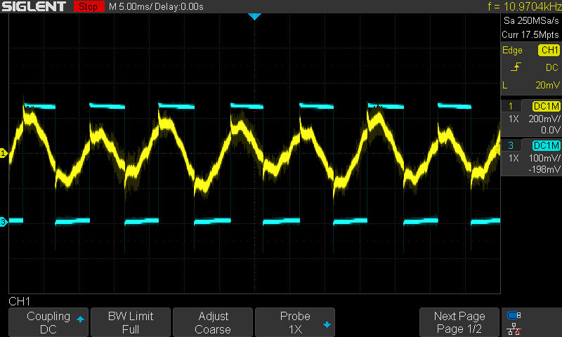

  • Got it, thanks. I've taken some of this into consideration and worked on improving the tune for our motors. One thing that we have noticed is that some of our motor are very sensitive to the MCT's parameters and some are not. I spent some time searching for an optimal drive configuration for one of the sensitive motors and have noticed the following:
    1) Motor performance varies a lot between motors, even from the same make/vendor. If I find the optimal tune on one motor I can get it to have reasonable efficiency but that efficiency seems to vary across motors of the same make/vendor anywhere from 25-50%. If I tune each motor independently I can get better performance but one tune does not seem to be all that stable across a batch of these motors.
    2)  With our optimal tune (found using a brute force search against all parameters with load + rpm held constant) we get the following waveform. I am not sure if this is why the MCT is so finick with these motors but it does not look like a good trapezoidal waveform. I have checked phase resistance and measured the back emf while backdriving the motor, both look good to me. Top image is CW and the bottom image is CCW.

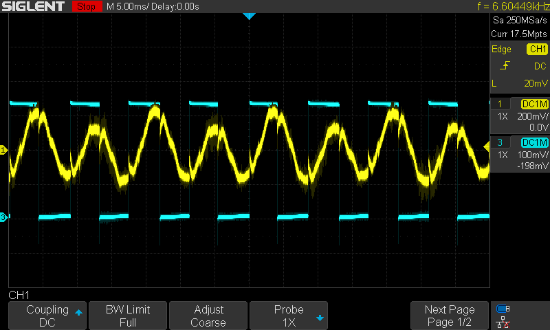

    Using one of the motors that is more robust to the parameters of the MCT we get this waveform:
    Do you have any thoughts about why some of our motors might not be playing as well with the MCT as others? We have tested these motors using a VESC and it seems to handle them much better without the need for any tuning.
  • Hi Michael,
    Thanks for sharing waveforms. This is very interesting.
    My best guess is to check the Hall sensor inputs back to the MCT8316Z for each motor. If the motor's Hall sensors are positioned a little bit differently for each motor, then there could be some uneven timings in the Hall comparator that yields poorer waveforms, like the first one you shared. The Hall sensors should be placed evenly between the motor phase coils, and the Hall input signals to the MCT8316Z should be even in their "active high" time. If they are not even, then there could be Hall sensor misplacement causing the poorer motor phase voltage waveforms.
    Could you capture HPA, HPB, and HPC for a good motor and bad motor and compare the Hall timings?

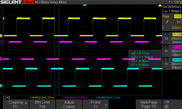

  • Here are HPA, B, and C. I captured data from two of the "bad" motors in both the CW and CCW directions and then collected the same for one of the good motors. Nothing looks particularly problematic to me based on their halls. For each motor I put the CW direction on the top and the CCW direction on the bottom. Note that with the bad motors we found that phase advance in the CW direction needs to be set to 0x07 / 30deg and in the CCW direction 0x00 / 0deg for best performance, sometimes the motors will not even spin if these are net set correctly for the direction the motor is spinning in.
    Bad Motor 1
    Bad Motor 2
    Good Motor
  • Hi Michael,
    These Hall signals appear fine across all motors.

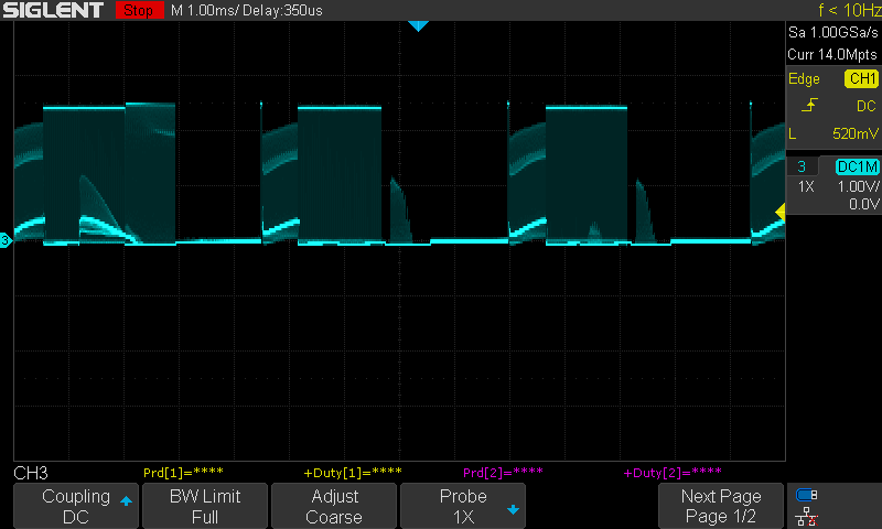

  • Those hall tests and waveforms are taken with no load other than the gearbox on each motor. I have also done some testing with 100Nmm constant load and I get similar results. The loads that I am working with should not have any directionality.
    I did some more testing today and noticed something interesting. I had set the motor to spin in the CCW direction with a 100Nmm load and a tune that was made for the CW direction.  The motor started out spinning in the CCW direction but suddenly switched to CW and turned the motor with very high efficiency. The waveforms looked really good too. It even outperformed the tune that I had found using exhaustive search with the motor set to spin in the CW direction. Here is a picture of that wave form (one of the phase currents in green):
    Comparing that to CCW (top) and CW (bottom) tunes it looks much better:
    Not sure if it helps but this is the configuration we have been using for the drivers:

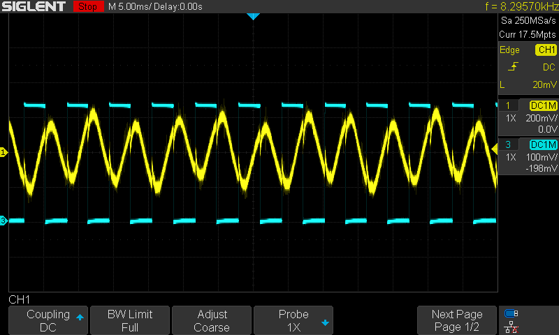

    Can you share the BEMF and Hall signal plot after spinning the motor by hand? This can help us measure the angle between the phase coils and Hall ICs.
    Aaron

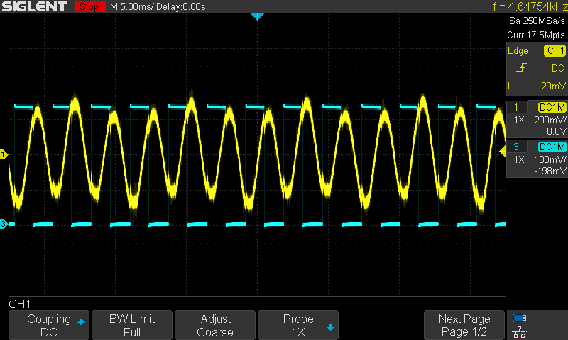

  • This should be every hall + phase pair in both the clockwise and counterclockwise directions. The motor was back driven with a drill.
  • Hi Michael,

  • Hello. We have been able to resolve all the issues we were seeing by rotating the hall inputs counter to what was in the motor datasheet. Specifically we connected the hall for phase A on the motor to the input for phase B on the driver, B on the motor to C on the driver, and C on the motor to A on the driver. Doing this has increased motor efficiency and the motor now spins reliably under all parameter configurations!
    While we have resolved this issue for our application we would like to understand better why it was necessary to rotate the halls like this. We had issues with multiple motors from different vendors vendors and rotating the halls solves the problems we had with them when they were wired up according to their datasheets. I find it hard to believe all these motors had incorrect datasheets so I am wondering if there is another reason why this might be required.

  • Hi Michael,
    I spoke to my colleague about this to improve my understanding.
    When Hall sensors are added into BLDC motor phases, there can be a slight "offset" depending on Hall placement. Typically, Hall sensors should have 0-degree placement or 30-degree placement, meaning that the Hall sensors should be placed no more than 30 electrical degrees behind (lagging) the zero-crossings of the phase current. If the current is positive, the Hall sensor should output a High or Low signal, and vice versa.
    If the Hall active high voltages are lagging between 0-30 degrees due to Hall placement or motor inductance, then you can use the ADVANCE feature to introduce lead angle and delay the Hall signal inputs to the commutation logic to align the motor phase voltages with the motor phase currents.
    If the Hall active high voltages are lagging more than 30 degrees due to Hall placement or motor inductance, then you'll need to use an MCU or intelligent Hall sensor devices that can correct the angle by adding a manual delay.
    For both cases above, this assumes that all Hall sensors have the same offset, which means they are placed exactly the same distance apart if they are not placed 60 degrees between the motor phases. If they have different offsets, then you'll have to tune each Hall signal output accordingly with an MCU to align the motor voltage and phase currents together.

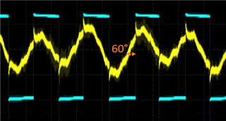

    In the waveforms above, I am not sure which plot goes with which phase and/or direction, but we can clearly see that the first 3 plots appears to show the Hall transition to HI leading the zero-crossing by 60 degrees, which means the Hall sensor needed to be switched to the next position (A --> B, B --> C, C --> A) to fix this.
    If the motor manufacturer has the Hall sensors added to the motor, I would suggest reaching out to them to determine if this is an error or if these are 60-degree placement Hall sensors, which I know some motor manufacturers do but is not really common.
