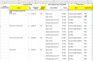

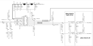

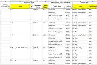

The attachments include DRV2510 application circuit in my project and a Excel file, the Excel sheet "FMEDA" to assess if every component has failure issues, how about the haptic feedback function, affected or not?
Please review colomn "M", if they are right or not. Thanks.

    Based on what was attached I have a few notes on what I believe could be changed
    R129 short - no effect
    C119 open - incorrect haptic feedback/ device issue
    L101,102 open - loss of KL30_L_1
    R131-137, and C122-125 0.5x and 2x could change the filter properties and give incorrect haptic feedback
    Arthur
