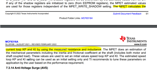

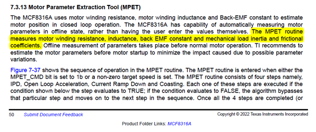

I am working on an improved control strategy for a specific motor and I will need to know the mechanical parameters (load inertia and frictional coeffient) of the motor. I've seen on the MCF8316A Datasheet that these parameters are estimated with the MPET. However, I didn't find any way to access the values of these parameters on the MCF8316A_GUI. All the references take me to the electrical parameters only.
Can anyone help me with this?

    From datasheet info, I believe the MPET process may only store the calculated KP and KI values rather than all of the motor parameters.
    Will let someone from our team confirm shortly
    Andrew
  • Hi Alisson,
    As Andrew pointed out, MPET estimates the mechanical parameters internally and uses them to calculate Kp and Ki. However, the values for the estimated inertia and frictional coefficients are not stored or accessible to the user.
    Eric C.
