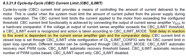

Is there any specific data on the delay that occurs with each gain of the current sense amplifier?
We refer to the datasheet below.

Higa,
We do not have any data to share but these delays will be in the order of few micro seconds.
