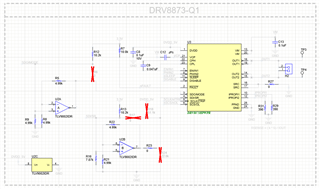

    It looks like the Opamp is being used to adjust the slew rate on the Hardware (H) version of the EVM. Instead of using jumpers to select the resistances shown in 7.3.3.2 Slew Rate, the MCU sends certain signals to the op-amp that the chip then interprets as the desired values.
    Here's a pic of which parts are populated/not for the Hardware version:
    Note that you won't need the op-amps for your circuit, you can follow 8.2 Typical Application schematic and put in the desired resistor values.

  • Hi
    Thanks for your reply.
    The schematic that you shared is actually the hardware version of EVM schematic which i am not able to find anywhere. Even at hardware EVM page, it says H version design files but when open then it is same as software.
    Can you provide me design files for hardware version?

  • Hi
    I setup resistors values for MODE and SR Pins. I put all recommended resistors using 0R resistor so i can do testing and choose the best out of it.
    Now, I need help in selecting IPROP and ITRIP pins resistors. I believe, we can fix ITRIP resistance as well instead of controlling it via MCU. As I am using hardware version. I am not sure, how to do it.
    Can you help me to define the resistance values for both?

    1513.CIRCUIT.pdf
  • Hey Ali,
    Looks like something went wrong with the PDF you uploaded, it is blank when I open it.
    The nOL pin is the open-load diagnostic control pin as described in Pin Functions and 7.3.2.4.1 Open-Load Detection in Passive Mode (OLP) .
    Work through section 7.3.1.4 Internal Current Sense and Current Regulation, it details how to choose those resistors and the other considerations that are required.  The range of current only goes up to 10A so you won't be able to measure 70A as shown in your table above, choose what you want to be the stall torque.  I recommend running your motor and measuring what the current normally is when not stalled, then choosing an appropriately higher value for the ITRIP current level.

  • Sorry for blank file.
    Plz check this
    7563.CIRCUIT.pdf
  • I tied nOL with DVDD because I didn't understand much about this test. I don't want to make things complex so i disabled it. I believe it is for detection of the load.
    Also, If i consider EVM resistor values 390 ohm for IPROPl then current will be
    RSENSE = ( k * 5) / IOUT
    IOUT = 5500/RSENSE
             = 5500 / 390
             = 14A
    The device can't provide current more than 10A so how this value is calculated?
  • Hey Ali,
    I think the EVM uses 390 ohms so that the IPROPI pin will always output something even if the customer runs the chip up to the limit.
    The paragraph above the RSENSE=k*5V/Io equation says "The selection of the external resistor should be such that the voltage on the IPROPI pin is less than 5 V."  So I think they put 5V in the equation to show the max.  During normal load of let's say 6A, the output voltage would be 390Ω * 6A / 1100 = 2.12V.
  • Ok,
    Let's say, I also use 390Ohm but how they are controlling Itrip because it is direction connected with MCU. In the harware version, How ITrip is setting current limit. There is no other components attached with it
    I read all datasheet but I couldn't find much detail or clear details about these two pins i.e. IPROPI and iTRIP.
    I need the driver to provide 8A of current and when current exceeded 9A then it should stop. Can you simply tell me the resistance values for it for both pins?
    The equation doesn't make sense to me.
