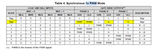

  • Ì have found a possible cause of the issue, it's the hall effect sensors. When meassuring them directly with a logic analyzer I could notice a raise and drop in their voltage, although when connected these hall effect sensors to INLA, INHB and INLB from the bottom and connecting the logic analyzer on top, I haven't seen any switching when moving the shaft of the motor.
    The issue persisted when I attached the hall effect senors to J2 and connected the HALLA,HALLB and HALLC outputs to INLA, INHB and INLB. This time logic was high, when brake was turned high the DRV board responded by attempting to commutate.

    Just to confirm, you have R36, R37, and R38 connected with 0-ohm resistors or shorted?
    Can you share the output voltages of the Hall sensor outputs HALLA, HALLB, and HALLC if possible on an oscilloscope? Ideally with the 3.3V pullups from resistors R29, R30, and R31, you should see the Hall states toggle as you spin the motor my hand and ideally should see all six possible states from the 1x PWM commutation table in the DRV832x datasheet.

    I couldn't get a hold of 0-ohm resistors currently so I had connected HALLA/B/C to IN/LA/HB/LB with a wire terminal wires. When meassuring the waveform from the wires connectiong HALLA-INLA, etc, I have not seen any of them change state. I'll have to mess around with the hall effect sensor a bit more. As for the motor information.

    • 3.) Haven't seen a change, it's locking up on the "ALLIGN" commutation table move.

    I belive the issue is now purely laying within the Hall Effect sensor feedback. I'll attempt a few more ideas of mine to see about getting a signal though to the DRV, but any ideas that you have, I would be also appriciated to hear out.

  • Hi Patryk,
    Thanks for sharing waveforms. I think there is a 10x attenuation happening in your waveforms, but I think we see that phase A has synchronous PWM outputs, phase B has the low side gate high, and phase C has the low side gate high, which indeed is the ALIGN state.
    Could you try removing R29-R31, or replacing with weaker pullups like 10kohm or 100kohm? The 1kohm pullups are pretty strong pullups, and the current sourced from the Hall sensors may not be strong enough to pull the Hall state low to a "0" if that is the case.
    Aaron
  • Hi Aaron, sorry for the late response, I moved to another device lately. Although! I got the motor to spin, turns out the hall effect sensors of the motor I was using weren't pulled up. When I hooked up another motor, we plan on using the hall effect sensors were properly pulled up.
