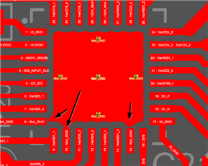

We are using a DRV8705S motor driver IC for our application. For this motor driver we have attached layout file below which we design.
Please review layout and let us know your comments.

Hey Sonali,
I just spent about 20 minutes looking over your layout, it all looks very good. You have the capacitors close to the driver where possible, everything is rated to the same or higher voltage than recommended, and I don't see any issues anywhere with power planes or too small of vias. Great job, seems ready for manufacturing.
One small thing I found was some of the pours seem to be close to reaching a pin but doesn't quite make it - this isn't an issue because there are vias nearby connecting to a ground pin, but I thought it maybe worth mentioning checking your rules or manually adding a trace:

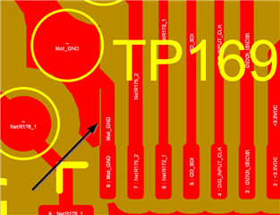

And another weird pour here, once again shouldn't matter:
