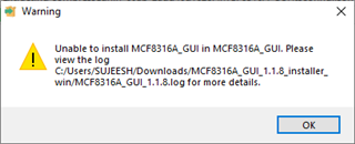

Dear Team,
I tried installing the MCF8316A_GUI and encountered with the following error
  & "product_fullname_with_underscores = MCF8316A_GUI"
System configuration are as follows,

  • Hi Sujeesh,
    Are you able to view/open the log file as shown in the warning message?
    Could you please attach the log file if possible?
    Eric C.
  • Hi Eric,
    The last line of the file says "product_fullname_with_underscores = MCF8316A_GUI"
    MCF8316A_GUI_1.1.8.log
    I have attached the file for your reference.
    Sujeesh
  • Hi Sujeesh,
    Thanks for providing your log file. The "product_fullname_with_underscores = MCF8316A_GUI" itself is not an error message since it is also present in my successful install log file. I've forwarded your issue to our GUI composer team, so please give me a couple days and I'll get back to you
    In the mean time, could you please try running the GUI installer as admin and see if it helps? (Right click on the setup file -> Run as administrator)

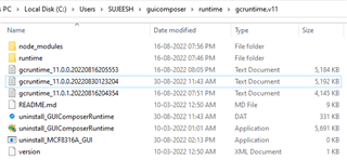

  • Hi Eric,
    Sorry for the delayed response. I was out of office and I had no access to the system.
    These are the files and folders available in "gcruntime.v11" folder. There is no temp folder.
    gcruntime_11.0.0.20220830123204.log
    I'm attaching the log for your reference.
    I can see launcher.exe in these folders.

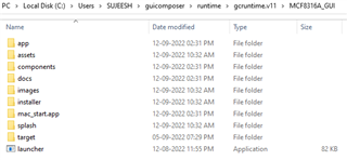

  • Hi Eric,
    Sorry I mistakenly clicked the resolution switch.
    I copied the folder as requested
    And ran the launcher. Nothing showed up. So, I ran it from CMD prompt.
    No errors and nothing launched.
    Sujeesh
  • Hi Sujeesh,
    Thanks for the update.
    It looks like your MCF8316A_GUI folder is missing several other files. This is quite odd since the initial log file you provided did show those files being extracted.
    Please give me some time to consult with our GUI Composer team and I'll get back to you.
