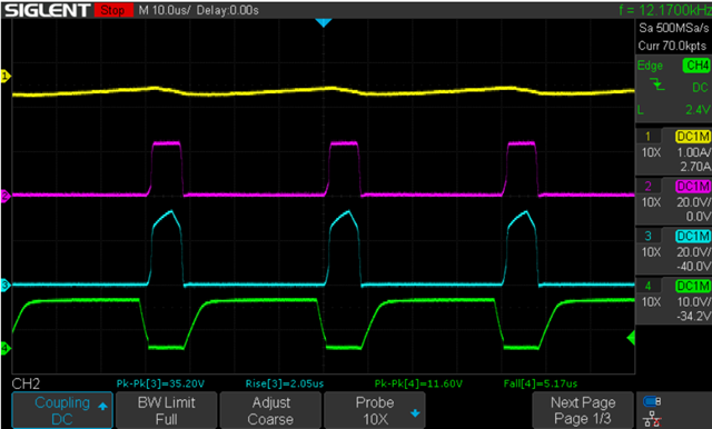

    I did quite a bit of extensive testing a while back on the eval for the DRV8323 and using a VM of 24V I was seeing GLx range between 12V to 18V depending on the test I was doing. But it looks like it was a function of how much IDRIVE current is selected. This leads me to believe that the jump to 18V might be due to trace inductances between the Gate driver and the FETs.
    This is with the highest gate IDRIVE settings
    CH1: IOUTA, CH2: VOUTA, CH3: GHA, CH4: GLA
    This is with the lowest gate IDRIVE settings
    But if the LDO for the Vgls is truly set to no more than 12V then that's all I need to know. From the datasheet it looked the like the Vgls scaled with Vm...

  • Hi Jerome,
    If your IDRIVE settings are too high and there's high trace inductance in the gate drive outputs, then because of the equation V = L * di/dt, high IDRIVE settings may cause too high of a change in gate drive current (di/dt) so that if there's too much inductance in the gate drive outputs (L) then this can cause an increase in voltage (V).
    From your IDRIVE settings below, you may need to choose an IDRIVE setting that is appropriate in value based on your MOSFET's Qgd value and the amount of gate drive current that can be supported based on gate driver layout.
    For more info, please see this E2E FAQ: e2e.ti.com/.../faq-selecting-the-best-idrive-setting-and-why-this-is-essential
