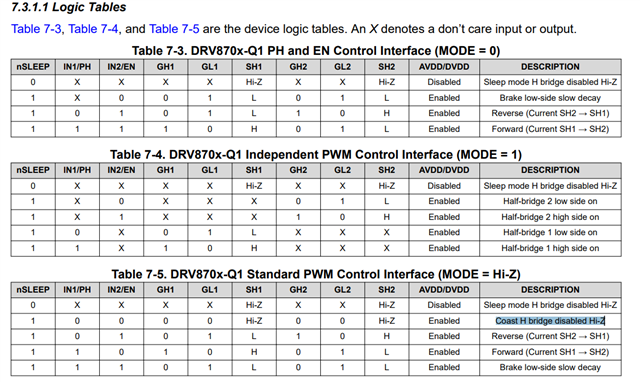

I have two questions about DRV8703-Q1.
1. Why do we need "Coast H bridge disabled Hi-Z"? What kind of function does it achieve?
2.For below three modes, PWM signal is fed to which pin, EN or PH, in order to achieve speed changing? Thanks.

    1. Coast mode allows the motor to spin down slowly instead of quickly bringing the motor to a stop.  This will result in the least mechanical stress on the load and the shaft, as it will spin down as if the motor was spinning and was disconnected from the motor driver.  Depending on the inertia of the load this could happen quickly or take several seconds to stop.  Here's a more thorough description of coast mode from this E2E post:
    In coast mode, the output terminals are set to High-Z state (open) as shown in Table 1 of the datasheet. The current in this case will go into fast decay mode. In fast decay mode, the current is not maintained in the coils and instead flows back to the input source (input bulk capacitor). Effectively, the motor will continue to keep spinning and that is why it is called "Coast". If input cycles are continued to be sent to device, the motor will be accelerated during the ON time and will "Coast" during the OFF time and this will continue to happen until there is a balance between the energy added during the ON time and the energy dissipated during the OFF time. If input cycles are stopped being sent to device, them the motor should "Coast" to a stop but the time it takes to stop will depend heavily on friction.
    2. Apply the PWM signal to IN1 or IN2.  Use the other pin to choose whether it coasts during the off-time of the PWM signal or if it low-side brakes - for example, if you PWM IN1 and set IN2 to HIGH(1) then you'll be driving in Reverse and Brake low-side slow decay if I'm reading the table correctly.

    Thanks for sharing these. If i understanding correctly, Hi-Z and Brake low-side slow decay are two different way that the motor speed down. The main difference between them are the current path and energy conversion.
    I see your latest explanation but I still don't find the relation about these two ways. How can they decide which way for decay, fats or slow? What kind of parameter they may need consider? Thanks.

  • Hey Elec,
    Check out this document: Application Note:  Current Recirculation and Decay Modes
    And https://www.ti.com/lit/wp/slyy066c/slyy066c.pdf#page=3
    And here's a good answer about them:
    Decay mode setting usually plays obvious effect on high degree microstepping, such as 1/4 to 1/256. It is true that you can hardly tell any difference in full step as the decay mode changes.
    For more about the decay modes setting, you can first refer to most of the DRV8x datasheet including DRV8811 and understanding the fast, slow, mixed decay function. The reason and purpose we do different decay modes setting is to let the current go down or up as quickly as possible according to the setting value determined by Micro stepping index. Usually, if the current is regulated the more sinusoidal, the more smooth running, and less noise and torque ripple.
    Generally, Fast decay usually is needed for high inductance motor, high running speed, high degrees micro stepping which all need the current change quickly. But fast decay brings audio noise sometime, also more heat and switching loss.
    Slow decay will have less audio noise and better output torque level at low speed running.
    Sometimes this is best to test in the complete assembled system, as many factors can affect how the motor runs between friction, inertia, vibrations, speed, etc.
    Jacob
