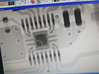

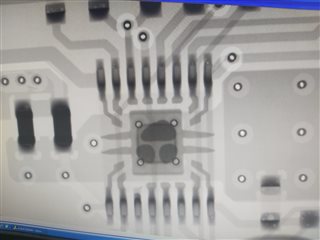

    2. We X-rayed the PCBA with both DRV8876PWPRs burned out. See attached pictures pic1 and pic2. In our opinion, there is a clear lack of solder. It should fill the entire area of the pad and flow into 5 vias for better thermal conductivity. But we don't think this could be the main reason for the failure of DRV8876PWPRs. What is your opinion?

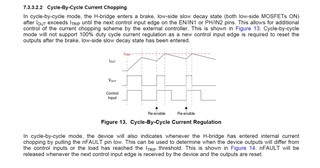

    5. That is, Current Chopping Response Mode is Cycle-By-Cycle. However, as seen in 7.3.3.2.2 Cycle-By-Cycle Current Chopping paragraph (see attached Pic3), it is forbidden to work with 100% PWM. In our application, it is quite possible that the PWM will reach 100%. Could this be causing the DRV8876PWPR to fail?
    I looked into this and eventually found the PowerPAD Thermally Enhanced Package application note, specifically the 5th paragraph in 2.4 Thermal Vias covers this (see image below) - you actually don't want the solder to flow into the vias, because then there's less solder connecting the power pad to the plane itself.  Here's the shorter version of that application report, which actually shows your layout matches the "REQUIRED STANDARD LAYOUT" with the vias in the area of the thermal pad.  Make sure your vias are 13mil diameter or smaller.
    That said, 10.2.1 HTSSOP (PWP) Layout Example in the DRV8876 datasheet does recommend 12 vias under the thermal pad, and looks like you only have 4:
    In conclusion on the lack of solder - The amount of solder shown in your x-rays seems sufficient for the thermal pad / via layout you designed, but your thermal pad and via grid could be improved.  I found surprisingly few other E2E posts with x-rays to compare with.
    I don't think so, but I would need to ask a more experienced coworker to confirm.  I think the device would just stop driving the motor until the input signal went low then high again.  The H-bridge would be in brake, low-side slow decay state, so the current shouldn't increase.  However, since you're searching for a software solution, I would try adding in a check that limits your duty cycle to 99% or 99.5% and see if that fixes anything.

    As about the solder on the thermal pad under the chip shows in the X-ray, even if not fully filled, this should not cause over-heat damage as the report indicated chips were damaged even when running the motor with no load during debugging and so no heat generated.
    Since the DRV8876 burns under load and without it, with and without visible physical damage, there may be more than one reason for this phenomenon. One of the reasons may be insufficient cooling of the chip. But this is only an assumption. Could this be real? Or is it incredible?
