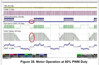

We found the behavior of DRV8306 is different from the operation mode in the datasheet.
As you can see in the below waveform, the GHA is switching when GLA is low which is not one of the operation mode in the above table.
May I know whether it is normal or what might cause the GHA switching while GLA is low?

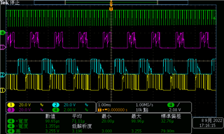

Condition
Ch1: TP24_PWM_ duty -> 20% high、80% low
Ch2: GHA
Ch3: GLA
Ch4: BLDC_U(SHA)
DIR -> Low
