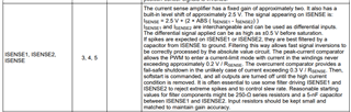

    So looking at this device datasheet functionality, we see that the relationship of INPUTS (H1/H2/H3, DIR) on OUTPUTS (PUA/PUB/PUC, PDA/PDB/PDC) is shown by the table below. PUA/B/C is meant to drive high-side PMOS type FETs, and PDA/B/C is meant to drive low-side NMOS type FETs.
    • The voltages you're describing suggest to me that the UCC device is not really able to drive the outputs ON at all currently. They seem to be remaining OFF.
    Some questions to help debug:
    1. is the customer seeing inputs toggle at H1/H2/H3? Any waveforms to share on this? If not, can they try to toggle them manually via GPIO or function-generator?
    2. what is the signal inputted on 'SPEED-IN' pin? I am curious if the outputs are being disabled because the overcurrent protection is activating
    Input-Output truth table
    ISENSE pin, which involves overcurrent protection & can trigger output shutdown
    Andrew
