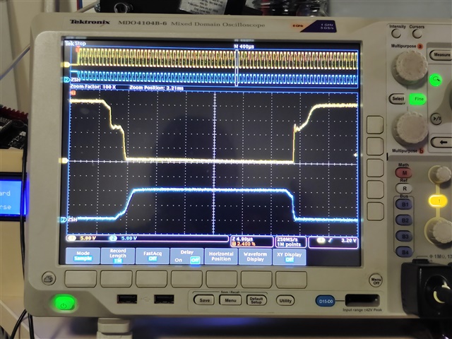

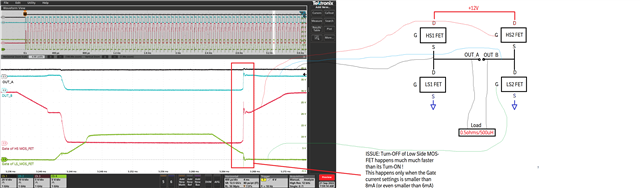

The trouble is that if the gate current setting is set to <6mA, the Turn-OFF of Low-Side MOS-FET happens very fast so practically there’s no slew-rate control in this case.
Please see below for more details.
Behaviour when Igate is higher than 8mA
Behaviour when Igate is smaller than 8mA
Behaviour when Igate is smaller than 8mA.
I noticed that this issue:
-  It occurs on the official TI Evaluation Board.
- occurs on LS2 MOS-FET for a gate current setting of 6mA or lower. For this I set the set the following control registers: DRV_CTRL_1 = 01010101 (for HS FETs) and DRV_CTRL_2 = 01010101 (for HS FETs).
- occurs on LS1 MOS-FET too, but for a gate current setting of 3mA or lower.
- occurs on both DRV8705 and DRV8706 (with the same thresholds of 6mA for LS2 and 3mA for LS1);
- occurs regardless of the Dead Time setting (I tested even the longest setting of 8us);
- occurs regardless of the load impedance (I tested loads between 0.5 – 10 ohms).

    I guess "I strong" may be the cause of that phenomenon. I would try to change VGS_LVL and VGS_TDRV and see if it helps.
    At first picture with normal waveforms rising time at OUT_B is around 400ns what is already quite a long time. I think extending it even further will only increase
    switching losses. I would probably try to stay around 100ns and keep voltage overshoots at a bit lower level than on second picture.

    Changing VGS_LVL setting does not bring any improvement.
    VGS_TDRV was set to 4us. I tested all the other three values and:
    - with 8us, the issue still occurs but for a lower gate current setting: <4mA (compared with <8mA with the 4us setting). So there’s and improvement;
    - with 2us the issue remains unchanged;
    - with 96us the issue distort the gate voltage slopes even more (see scope shot below).
    So unfortunately your proposals do not solve the issue, issue, but only improve the chip behavior.

    1."Can you explain the mechanism by which you think the I_strong current might be the root cause?" - looking at the second picture from top the problem happens around 4us after LS gate started to turn off (4 us is longer than half of TDRV settings) + Figure 7-8. TDRIVE State Machine from DRV8706 datasheet.
    " with 8us, the issue still occurs but for a lower gate current setting: <4mA (compared with <8mA with the 4us setting)" - that just confirms my suspicions.

    I haven't read the chip registers to understand the effect of VGS_LVL and TDRV, but a quick look at the scope waveform leads to my question: Why the deadtime from G2H going low to G2L going high is about 800ns, but deadtime from G2L going low to G2H going high is only 400ns? Why not having them the same deadtime value for whatever it is?

    Can you try adjusting ISTRONG by changing IDRVP? Could also try adjusting VGS_TDEAD, though unlikely to have an effect here.
