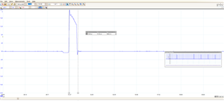

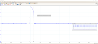

I'm having the audible noise from the motor caused by the jittering on the DRV8701E output GH1 and GH2 when the input EN is fed with a stable constant PWM signal (PH is set to either Hi or Lo). This jittering caused the driver PWM output to follow with the same jitter and caused the motor noise. I have 2 questions and hope someone can help point out how I can fix this jittering problem.
1. The datasheet spec lists tDEAD = 380ns TYP, but page 21 says the chip inserts a dead time of about 150ns -- conflicting --  and when I provided an input pulse of 400ns to the EN pin, all 4 gate driving pins were zero volt -- it seems to me 400ns PWM input is not wide enough but I can't find this violates the spec of tDEAD. Only when input with 500ns or wider pulse then the GHx output has signal. Could you comment on this?
2. With input supplied with a constant PWM signal with 600ns high pulse and 19.6Khz frequency, the GH1 and GH2 outputs have 80ns jitter on the falling edge, causing audible noise in the driven motor. The IDrive is about 4.2V so the gate signals should have fast slew rate (I am aware a slow rising/fall signal can cause jittering output). What is the root cause of the jitter?
I captured a series of the H-Bridge FET output and found out the jitter happened for every other pulses, which means the jittering is 19.6Khz/2 = 9.8Khz and this is the audible noise signature.

Pics of the driver output with alternate wide and narrow pulses to show the jittering:
  • The PWM input is precisely with 600ns pulse width, and so the Jitter-narrow waveform is the correct output, but the driver somehow widen the next output to more than 600ns as can be seen in the Jitter-wide pic. So the driver chip drove the output low late.

    2. With input supplied with a constant PWM signal with 600ns high and 19.6Khz frequency, the GH1 and GH2 outputs have 80ns jitter on the falling edge, causing audible noise in the driven motor. The IDrive is about 4.2V so the gate signals should have fast slew rate. What is the root cause of the jitter?
    Interesting, can you try it at a lower PWM frequency to give the FETs more time to switch?  I wonder if 20kHz is too fast for the FET+iDRIVE combination in this board. I posted on Pololu's forum asking for the specs of the FETs, hopefully they'll tell us, or maybe you can read the writing on the top of the FET on the board to determine what it is.

    2. I reduced the PWM frequency by half to 10Khz, and no change to the jittering issue. Please see waveforms below.
    Keep in mind that these waveforms are the FET output, but the same jitter is also on the DRV8701 output gate driver GHx signals.

    Below are the input pics with 600nS pulses: one at the scope triggered point, and the other right after and we can see there is no jitter on the PWM pulses generated by the SMT processor.
    As about additional bulk capacitance to the board, I don't think it's the issue because the board already has a ceramic and an electrolytic cap of at least 10uF or 100uF (with marking 100, HFT, 631 on the body) with 6.5mm OD and 7mm height, a good size, and then I only turned on the FETs for 600nS out of 10Khz frequency, or 0.6% duty cycle, so this tiny energy pulse should not cause the VM to have any noise from high current rush.
    By the way, even without motor connected to the H-bridge, the DRV7801 still have output jitter. I think it's time to ask the chip designer of what can cause the GHx to delay its falling edge at every other pulses.
    First pulse:
    Next pulse:
