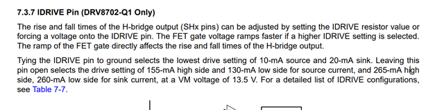

Hi Expert,
Why the peak sink current is approximately two times the peak source current? What's the purpose of such design? Thanks.
BR,
Elec Cheng
Hi Expert,
BR,
Elec Cheng
Hi Expert,
And also why high side sink/source ability is stronger than low side? Thanks.
BR,
Elec Cheng
