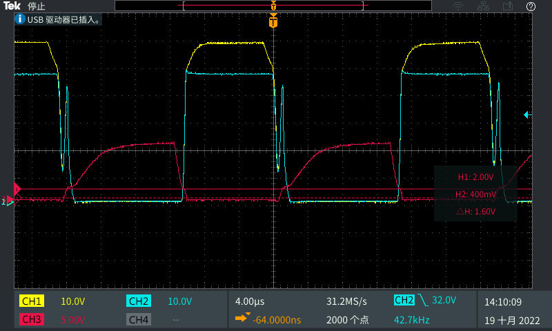

I use DRV8323RS to drive PMSM, but the MOSFETs are burned out at high current or VDS_OCP is indicated.
I think it's ringing problem and it seems that the DEAD_TIME does not work during the falling of CHB.
Can you help me check the following waveform and are there ways to improve?
VM: 48V
IDRIVEP_HS: 60mA
IDRIVEN_HS: 120mA
IDRIVEP_LS: 30mA
IDRIVEN_LS: 120mA
DEAD_TIME: 400ns
MOSFET: TPH3R70APL
RED: GLB, YELLOW: GHB, BLUE: SHB
  • Hi James,
    I think on both pictures dead time is around 350-400ns and it looks OK. Shape of SHB voltage suggests that current is flowing into SHB half-bridge on both pictures. Ringing on the second picture starts when SHB voltage starts to fall down. I can think of two sources of that ringing, the first is reverse recovery of HS mosfet body diode and the second is capacity coupling between gate and drain of LS mosfet (Cgd). I would try to lower IDRIVEP_LS if it was not already so low (30mA) or improve PCB layout to limit parasitic inductances in LS mosfet gate circuit.

    If you think the dead time is not enough and causing the shoot through leading to damaged FETs, did you feel the hi and low FETs were hot before damage occurred? I would carefully touch the FET to sense the temperature. According to the waveform of SHB, it looks normal to me. If a shoot through happened -- both hi and low FETs were ON -- then the signal SHB should have a value in the middle of VM and GND or about 24v during dead-time, but we don't see on the pic, and instead the SHB has a smooth transition from Hi to Lo, or Lo to Hi.
    GLB with some ringing, but this should cause no shoot-through as the GHB was clearly turned off 400ns before.
    The FET could be damaged not from shoot through current, but from high voltage spikes on VM or GLB and GHB.
    Brian

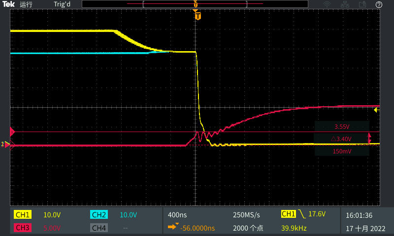

    1. The peak of ringing on the second picture is 3.5V which is over MOS Vth. I think there is a risk of short.
    2. There is a platform on the GHB falling edge, is this normal?

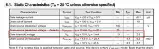

    The peak of ringing is over MOSFET Vth (2.5V) which I think may cause the short. I did not touch the MOSFET, but there were signs of solder seeping out from under the MOSFET. In some tests, the chip also reported MOSFET overcurrent fault.
    The motor works fine at low torque, but the MOSFET burns out at high torque, usually at about 10A bus current.

    "1. The peak of ringing on the second picture is 3.5V which is over MOS Vth. I think there is a risk of short."
    When ringing occurs on GLB (the second picture) HS Mosfet is already turned off and that level of ringing may cause SHB voltage to fall more slowly (like around 12V and 4V when SHB/GHB are flattened a bit) . If ringing is higher then it may cause false LS Mosfet turning off  when it should be turned on what would cause increased switching losses and probably more problems. If those possible problems could cause malfunction of HS Mosfet gate driver and lead to a shoot through I do not know. The problem here is not that the GLB ringing is over Vth but when it falls down below Vth.

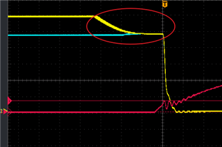

    The "platform" I mean is the curve in the red circle and I think I know how it came about.
  • Hi James,
    I think that everything in red circle looks OK. First the GHB is falling down, when it reaches Vth HS Mosfet turns off (SHB rises a bit because of Mosfet body diode voltage drop) then it falls further till it is equal to SHB. After that they both stay at VM+diode voltage drop level till LS Mosfet is turned on what is causing GHB and SHB  to fall to GND level.

    1. I agree with you that there is shoot-through current (both high and low FETS were on). You said the driver was set to have 400 deadtime, but the FET Gate slew rate is so slow that GLB took more than 400ns to go from 12v to 3v and at that moment the high FET was turned on with GHB also at 3v. I don't see ringing on SHB, so why not increase IDRIVEN_LS to much higher to turn off the low FET quicker? The driver chip can increase IDRIVEN_LS to 2A max. I believe these are big FETs with high gate charge, and so it is better to increase iDRIVE and reduce rise and fall time at the FET Gate to speed up FET turn OFF and ON to avoid shoot through.
    2. I don't think the ringing on GLB is the root cause of shoot through current, although I would increase IDRIVEP_LS:  more than 30mA as it took more than 1600ns for GLB to change from 0v to 12V with no benefit.
    3. At high current, 10A you said, slow turn on and turn off FET (more in linear region) generated a lot of heat even without shoot trough.
    I bet with high IDrive, the issue will be resolved.
