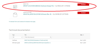

3)Is there DRV8714-Q1  H -bridge demo can ref?

    3) DRV871-Q1 EVM(Evaluation Module) can be referred.
    www.ti.com/.../DRV8714-Q1
