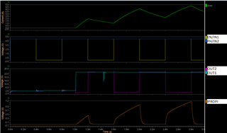

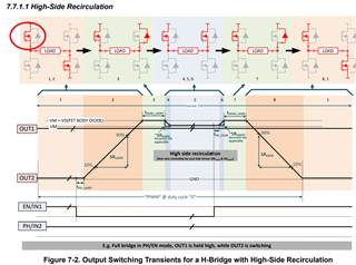

I have a question regarding current monitor on DRV8245S in EN/PH mode full bridge.
I see the current sensing is implemented in both HS FETs, I was expecting to have a sensing in ON phase (HS1 ON & LS2 ON) and OFF phase (HS1 ON & LS2 OFF, with sensing to HS2 in recirculation)
Using the downloaded spice model I see a current sensed only in ON phase (e.g. HS1 ON and LS2 ON).
Is my understanding correct?
Thank for your reply.
