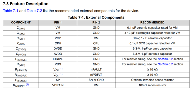

Hi Expert,
As you can see below, for some pins you recommend X7R, for some pins you just recommend ceramic cap. Does ClassⅠ ceramic capacitor also apply for them? Thanks.
BR,
Elec Cheng
