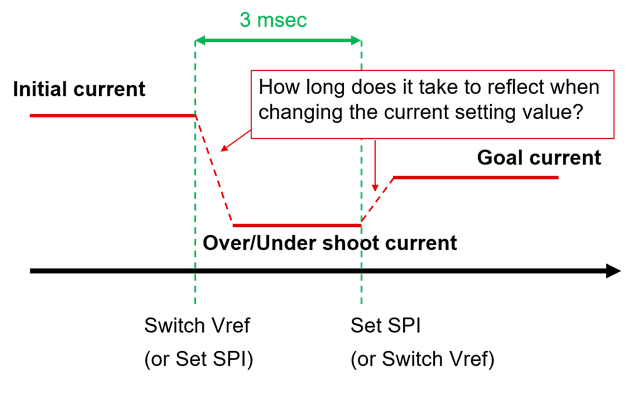

I have questions about the time from when the current value is set until the actual set current is output? Could you please answer them?
[Question]
(1) Response time or reflection speed [A/sec] when current output changes by switching VREF with SPI register constant
(2) Response time or reflection speed [A/sec] when current output changes by setting SPI register with VREF constant
If there is a corresponding part in the data sheet, it would be greatly appreciated if you could tell me where to look.
[Background]
My customer wants to vary both the VREF and SPI register settings to achieve a variety of current outputs. For convenience of microcomputer control, they set the current in order as follows: VREF switching → SPI setting (or vice versa order)
If you switch in order like this, a maximum time lag of 3 ms will occur between these two operations due to the specifications of the microcomputer.
Depending on the VREF and SPI settings, it over/under shoot the target current when switching as  the figure below shows. In the case of actual over/under shoot, they are investigating how much it will exceed in 3 ms. To clarify this point, they need your answer of above question.

  • Hey Taito,
    I will have to put in a design ticket to get the exact value, but I am fairly certain the response time is much faster than 3ms.  I would guess the response time is in the nanosecond range, so your over/undershoot current time would be close to 3msec.
    I put in a design ticket for this question, it typically takes them 3-5 business days to respond.

  • Hey Takemura-san,
    • VREF pin has opamp buffers at 1MHz bandwidth before they change the reference for coil current
    • TRQDAC(SPI) has 10MHz digital CLK before sending the updated bits to DAC to change the reference for coil current
    So changing the reference for coil current takes < 10us across all conditions. Its almost instantaneous.
    But coil current catching up with this reference depends on the coil inductance (which normally takes few tens/hundreds of usec to few msec)
    T = L * (New_I_reference) / VM
    If increasing current, VM  & L decide. If decreasing current, VM, L & chosen decay mode decide.
