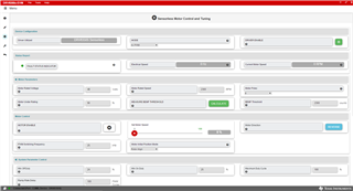

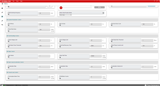

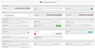

I have a problem with the start sequence, we use the firware SLVC755 sensorless withe the board DRV8350S-EVM.
The motor runs correctly without load.
With the load (a propeller for a fan) I can't get the motor to start I have an overcurrent error.
Which parameter is problematic ?

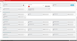

My configuration :
My result with the overcurrent error :
/cfs-file/__key/communityserver-discussions-components-files/38/20221020_5F00_165013.mp4
Thanks.for your help.

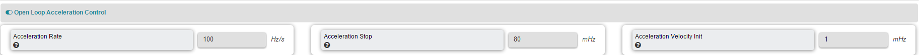

  • I saw an improvement without the load with the align method.
    With the load I get the same behavior as on the video of my first post.
    Now my error code on the GUI is acceleration.
    I try to change the values without success :
  • Now my error code on the GUI is acceleration.
    so the motor position detection for commutation is good now, but due to its very high inertia load , it failed to accelerate to the desired setting. For this application you should set the acceleration to low to avoid the said error.
    As said above, the setting of part open loop acceleration control does not allow me to go into closed loop.
    Here is more detail :
    The result :
    With low acceleration settings I get the overcurrent error.

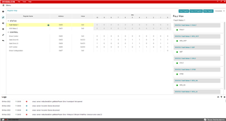

    Could you also provide a picture of the SPI registers when the fault is triggered? What drive current are you using?
    Akshay

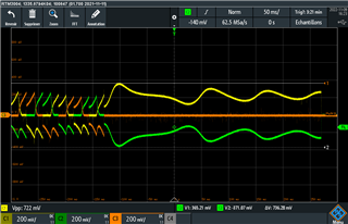

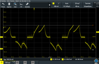

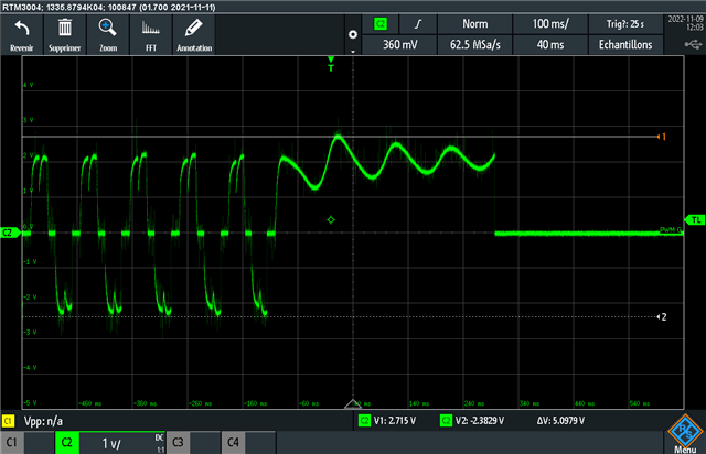

    Here a waveform of a phase current before the default overcurrent : (calibre of the probe 10mv/A)
    For the drive current i use this value :
    Thanks.
    Julien.

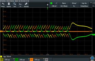

  • Also the waveform with the three phases at the same time.
    Julien.

  • Hi Julien,
    The last video shows the motor was running fairly good before shut down due to fault. I would think at that speed, it is safe to switch from open loop to closed-loop as the speed is high enough for BEMF zero crossing detection. How do you know the fault happened during open or closed loop? Can you read the status indicates open or closed loop control?
    what is the programmed value for START_UP_DUTY_CYCLE? This is the pwm driving the motor phases during open-loop running. Too high can cause over current limit at slow open loop speed.
    For the motor setting, motor poles = 8. Is this 8 pairs or total 8 magnets (4N + 4S)? If 8 magnets then 4 pole pair:
    2300rpm = 38rev/sec; electrical cycles = 38x4 = 152 Hz at 2300rpm.
    Given: Acc Rate=1Hz/s; Acc_stop=12mHz; Aligment Wait Time=50000 (pwm cycles) = 2s at 25Khz pwm.
    From the video, the motor was not settled during Alignment, so I think you should give more time for Alignment Wait Time by lower pwm = 15Khz instead of 25Kzh, and this will give Alignment wait time to 50000 x 1/15Khz = 3.3sec. The fan is noisy anyway, so 15Khz pwm noise cannot be heard and this also save FETs switching heat loss.
    Can Acc_Rate set to less than 1hz/sec? like 0.1hz/sec for the high inertia fan which needs more time to accelerate.
    Acc_stop = 12mhz means the control will switch from open loop to close loop when motor speed is 12mhz/4 = 0.003 rev/sec which is very slow and unreliable for detecting BEMF zero crossing. I would set it to 0.5 rev/sec = 0.5 x 4 = 2000mhz.
    I would also set Acc_velocity_init = 0 for this high inertial motor.
    Brian

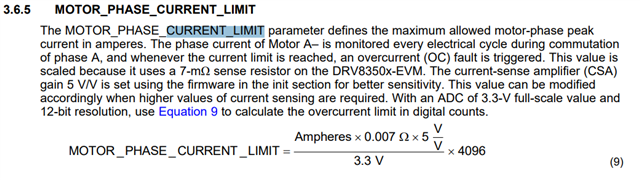

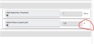

  • You set Motor_Phase_Current_limit = 120, which is not in 120 Amp, but only about 2.7A
    According to formula :I * 0.007 * 5 * 4096 / 3.3 = 120;
    so current I = 2.76A
    Since the board has max current 15A RMS, then I would safely set the limit I = 10A or MPCL = 434.
    Brian
  • Hi Brian,
    Do you think there is an error in the interface ?
    Because the max range allowed current is 120A in the application.
    Julien

    The acceleration rate min value is 1.
    The acceleration velocity min value is 1.
    if I increase the parameter Acc_stop I switch to overcurrent.

  • Do you think there is an error in the interface ?
    The EVM board only output 15A RMS max as spec in the datasheet, and so the GUI menu showing 120A is wrong.
    Can you try to set the current to 434 based on the formula, to have 10A?
    Brian

  • Because the max range allowed current is 120A in the application
    Hi Julien,
    Here is the Motor_Phase_current_limit calculationm from the User Manual:
    Brian

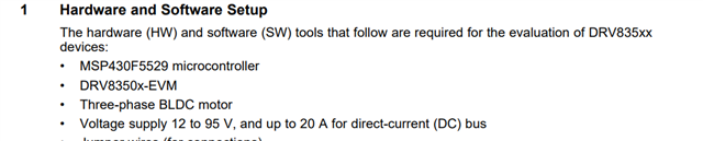

  • All,
    This thread will soon expire due to inactivity, is the issue resolved?
    -Adam
  • Hello, nothing is solved,
    I continue my tests in sensorless mode, I have to modify the hardware on the current measurement part to be able to reach my 2300RPM.

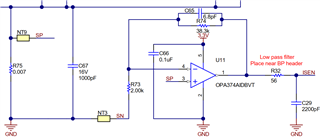

    With the current measurement assembly it is not possible to reach 15ARMS as indicated in the documentation.
    For information the following formula is false.
    For current measurement we have a non-inverting amplifier circuit u_i_phase_adc=((38.3/2)+1)*0.007*I_Phase.
    motor phase current limit = u_i_phase_adc * (4096/3.3).
    A lot of wasted time for documentation not updated.
  • Hey Julien,
    Apologies for the delay.
    The GUI takes current limit in Amperes and has a limit of 120A. However, the EVM is rated for 15 A RMS so we do not recommend setting above 15A to avoid operating above the board's current rating.
    Maybe you can try to limit the duty cycle to 20% to see if it helps avoid overcurrent and then switch to closed loop then increase duty cycle. You could also play around with the accel stop to figure out when would be the best time to switch into closed loop. By increasing this you will stay in open loop longer and get to higher speed and hopefully have higher backEMF.
    Please keep us updated on your test results.
    Akshay
  • Hi Akshay,
    As indicated above, I continue to work with the sensor. I will then come back to the sensorless part to test your suggestions.
    In the documentation it is mentioned : up to 15-A RMS drive current.
    Is it current per phase? or the current from the supply? this is not very clear to me.
    After having studied the connectors, the mosfets and the pcb, I don't see why we should limit ourselves to 15A Max per phase if this is the limit imposed.
    Thanks.
    Julien.
  • Hey Julien,
    The 15A is the continuous motor phase current. The board is designed to work under that limit to not violate the design recommendation. There might be some traces or other components that could get damaged if operated at higher current.
    Akshay
  • With the current measurement assembly it is not possible to reach 15ARMS as indicated in the documentation.
    Hi Julien,
    Why do you say the formula is wrong? I believe the parameter MOTOR_PHASE_CURRENT_LIMIT is not the actually limited current flows in the motor phase, but rather it is the ADC value from the 12bit ADC converter for the current 7m Ohms current sense resistor. So to set the motor phase current limit to 15A, you should write 651 to the MOTOR_PHASE_CURRENT_LIMIT instead.
    Brian
  • Hi Akshay,
    In the GUI, I believe the value 120A setting for the MOTOR_PHASE_CURRENT_LIMIT is not the actual motor phase current, but it is the 12bit ADC converter value which is the scaled of the actual phase current. In fact, the GUI is wrong to have the unit "A" assigned to the MOTOR_PHASE_CURRENT_MINIT PARAMETER as this cause confusion. Therefore, 120 is not the max limit the GUI can be set as it can be set higher than 120. I.e. it should be set to 651 in order to have the motor phase current limited to 15A.
    Brian
  • Hi Brian,
    Gain 5 does not correspond to my material. I explain :
    Only DRV8353 and DRV8353R have the internal shunt amplifiers, 5-V/V is the CSA_GAIN parameter for DRV8353.
    My DRV8350S-EVM board only uses external current measurement with a non-inverting amplifier circuit.
    Julien.
  • Hey Julien,
    Please keep us updated on your testing.
    Akshay
    Hi Julien,
    So the 8350 driver doesn't have Vsense OCP, and so the sensor-less motor was shut down not due to current limit protection, as the driver doesn't have this feature. So do you know what caused the driver to shut down when running with sensorless mode?
    Brian
  • Hey Akshay,
    Here is an update : to perform my test i have change the R shunt R75, i put a reistor of 0.003.
    I have change this resistor for use my board at 15A RMS without overcurrent default.
    I have tune the I PHASE PARAMETER to arround 40A (13A on the GUI).
    With the resistor of 0.007 pic current pass the software on overcurrent, and does not allow the development board to be used at 15A rms per phase.
    I could also have made a modification to the software, filtering the current peaks, but I preferred to keep the overcurrent fault as it is.
    So I was able to do my tests in sensor mode at 15A rms per phase with my speed at 2300rpm, it works.
    I still have to check the performance, the shape of the phase current seems to me to be non-compliant for a trapezoidal piloting.
    What do you think of this power drop?
    Julien.

  • Hey Julien,
    I will consult my team and try to find out why you are seeing these dips.
    best,

  • Hi Akshay & other TI staffs:
    Hey Julien
    The formula below is listed in the DRV835xx-EVM Sensorless Software User's Guide, which is WRONG!!! This has wastes Julien and me (and many other users for sure) a lot of times as we assumed this is the current limit to be set in the GUI, but this formula is for DRV8353 only.
    For DRV 8350x-EVM, the formula should be as followings, as the amplifier gain is G=20 and not 5:
    MOTOR_CURRENT_LIMIT = Amperes * 0.007 * 20 * 4096 / 3.3
    Which means at max u_i_phase_adc value of 4096, the motor current limit is 3.3/(20 * 0.007) = 23.6A
    So TI staffs should update the User's Guide document to add this formula for the DRV8350x boards.
    Brian
  • Hi Julien,
    I noticed your formula is not right; should be  motor_current_limit as it is not just one phase but the total motor current flows through one 0.007 Ohms Rsense.
    motor_current_limit = Ampere  * 0.007 * 20 * 4096 / 3.3;
    Brian
  • Hi Julien,
    I believe the DRV8350-EVM board has max motor current at 20A, not 15A, based on the document below:
    If you want to set the motor current limit at 15A, the program value should be when using the stock 0.007 Ohms Rsense:
    15A * 0.007 * 20 * 4096/3.3 = 2606 which is the ADC converter output.
    Question: when you enter the current limit value to the GUI, should you enter the ADC converter value or the motor current in ampere?
    Brian
  • Hey Julien,
    The dip you see is expected in trapezoidal commutation, and is know as torque ripple (happens every 60 degrees). This occurs due to motor switching phases and the motor(inductor) resisting change in current.
    Akshay
  • Hi Julien
    The waveforms of the 3 phase voltages should be unipolar -- above Ground. It seems on the scope pic the waveforms shown to have negative voltage. Can you confirm this?
    Brian
  • Hi Brian,
    Yes, I did notice a longer start-up time before the engine started to turn.
    Despite these settings I still can't turn my propeller normally (in sensorless mode).
    Julien.
  • Here are the three phase currents
