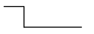

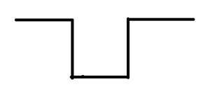

We are working on one project in which we have used DRV8830DGQR motor controller. As per datasheet when motor goes into stall condition, fault pin goes low and retains in low state till the fault condition is there. Practically while testing, we observed that it is giving pulse on fault pin. It does not retain in low state though motor is in stall condition. Also we are getting noise (low amplitude pulses) before getting the pulse on fault pin. It becomes difficult for host controller to sense the fault condition due to these multiple pulses.

        We have captured the pulse on the Fault pin, I am attaching the image.

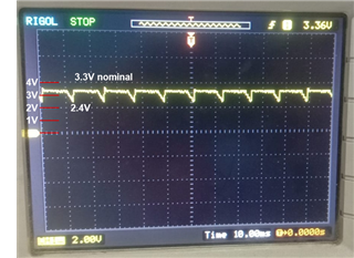

    I am sending you the requested waveforms for your reference, Please find below.
    1. VCC signal waveform:
    In normal motor operation, VCC voltage level are uniform, there is no fluctuation.
    If we tried to stall motor by putting external force, we are getting changes in the waveforms. Please find below image.

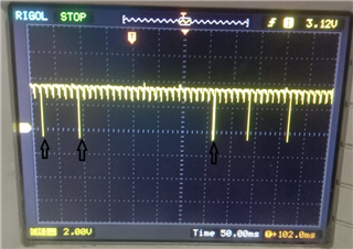

    2. Out x1 :
    In normal motor operation, Out X1 voltage remains high, there is no fluctuations.
    3. Out x2 :
    In normal motor operation, Out X2 voltage remains low, there is no fluctuations.

  • Hey Suraj,
    It looks like during stall VM is dropping to approximately 2.4V.  According to 6.5 Electrical Characteristics, UVLO conditions occur below 2.47V. Higher bulk capacitance could potentially fix this issue, I would try 22uF or 47uF instead of 10uF.
    So the device disables the H-Bridge and internal circuits, then VCC recovers to VCC > VUVLO, then the device tries to run again and the cycle repeats.
    This is occurring before the OCP trips.  With a 0.22Ω sense resistor the current trip point is 0.9A for OCP.  For your system since your stall current is around 220mA, you probably want a ILIMIT point more like 300mA.  This would need sense resistors of RISENSE = 0.2V / 0.3A = 0.66Ω using the same calculation as in 8.2.2.2 Motor Current Trip Point.  NOTE:  There's a typo in the datasheet, it should be "To set IILIMIT to 0.9 A, RISENSE" not 0.5A.  Maybe try this higher sense resistor value.

  • Hi, We are more concerned about fault pin status. As you can see, Fault pin gives pulse when fault occurs. As per datasheet, when fault occurs, it should go to low and retain same logic unless we clear fault.
    Current behavior is - Fault pin goes to low, but doesn't remain at low
    Expected behavior is- Fault pin goes to low after detecting the fault, and retains same logic till we clear the fault
    This is as per my understanding.
    Akshay
  • Hi Akshay,
    It is correct that for OCP case, the nFAULT will stay low until cleared by writing to the registers. But for UVLO case, the datasheet doesn't say the FAULT pin is latched low: "Operation will resume when VCC rises above the UVLO threshold."
    I also think the reason you have pulsing on the FAULT pin because the chip got to under voltage protection then VCC recovered to normal. To test this theory, please use 5A or higher power supply with short leads connected to the pcb, and importantly, add more cap to VCC -- just try with 470uF 5V, close to VCC and GND pins.
    Brian
  • Hey Akshay,
    Brian is correct - expected behavior for UVLO case is that fault pin clears (goes back high) once VCC rises above UVLO threshold.
    Please test with more bulk capacitance, we are fairly confident this is a UVLO fault not OCP fault occurring and clearing.
