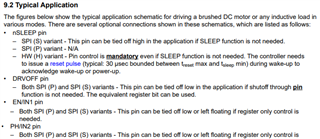

My customer hopes to use Register only control method to drive BDC. According to below description, I think it is feasible, and the register only control method can achieve the exactly same function with pin only control method, right? If they use this method, they can float IN1, IN2 and DRVOFF pins, right? Is there any risks here?
In addition, how to connect nFault pin if not used?

  • Hi Sherry,
    10KHz is not slow I think but it is customer's decision. 10KHz PWM should have two toggle in 100us. Each SPI comment is ~2us period with 10MHz clock. MCU mush keep sending at least two command in 100us.
    These pins can be floated. Please refer datasheet 9.2
    regards

  • Hi Sherry,
    I think it depends on the application of the motor control -- simple like running a fan or high performance like 10bit pwm servo control.
    I would only use SPI_pin control  for S_EN_IN1, S_PH_IN2 only for simple motor application as it requires the host processor to write twice to the SPI_IN register per every pwm cycle. Imagine for a typical servo closed-loop control, I would use 10bit PWM and 20Khz pwm, then every the host needs to write 2 times every 50us to the SPI_IN. This doesn't sound too bad, but consider this worst case: the PID control loop needs to output a pwm value of 1 (100% is 0x3FF for 10bit pwm), so the host first write the bit to 1 at time t1, then it needs to toggle the bit to zero at t2, which is 97ns after t1. The host needs to run a Timer counter interrupt every 97ns to trigger a SPI write. Do you want to do this?
    I don't know why TI engineers didn't add a PWM register for the SPI version, either 10bit or 8bit register, then the driver chip just has an internal pwm generator taking the 8bit or 10bit input via the SPI. This helps off load the host from writing the SPI_bit .
    Yes, IN1, IN2 and DRVOFF can be float as they have internal pull up or pull down.
    Since nFault is an output, you don't need to do anything if you want to read the nFault status using SPI.
